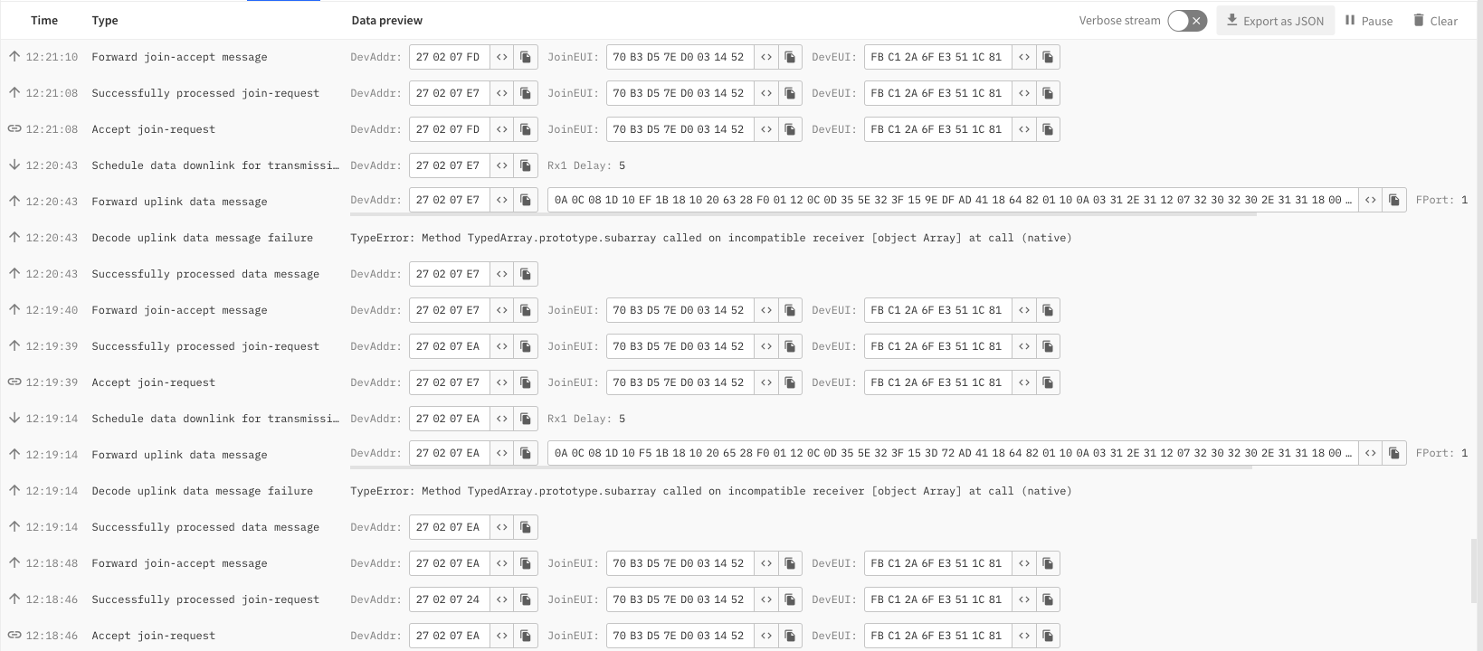

My end device keeps sending a join request and the join accept being accepted. Everything looks normal (to me), but something must be wrong somewhere, and I’m struggling to figure out, what it could be. And help or ideas are very much appreciated. Please see the logs below.
Logs
I’ve posted the logs from the live data tab of the end device in The Things Network below. Also the log from the gateway:
Logs from TTN (uploaded since too big for the post):
woody3536_live_data_1719484290368.json (210.3 KB)
Screenshot of Live Data tab in TTN:
Logs from gateway (logread command):
