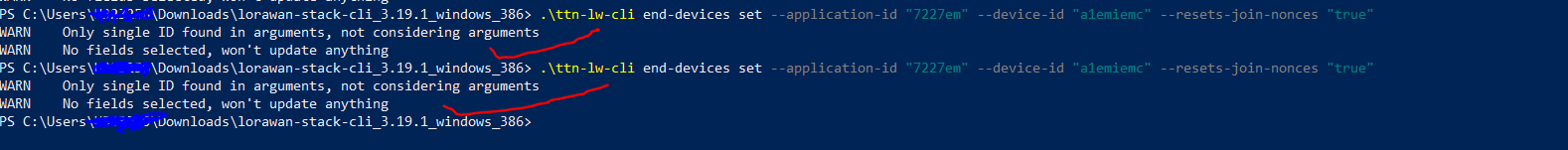

I haven’t investigated this fully but the work-a-round for now is to use the CLI to reset the devnonce on TTS.
