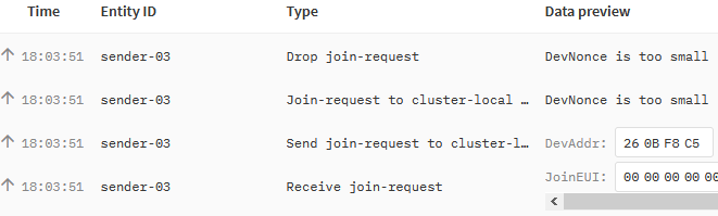

Hello, I have a self-build node using an RN2483. I connected the device successfully to The Things Stack V3, it was running as I expected. But after disconnecting from and reconnecting to power it did not join, the message “DevNonce is too small” appeared:
grafik
What to do now? How can I manage to make the device joining again?

Please select mac 1.0.1 (firmware < 1.0.5) or mac 1.0.2 for your device.
Thank you for the information, it’s running now properly!
