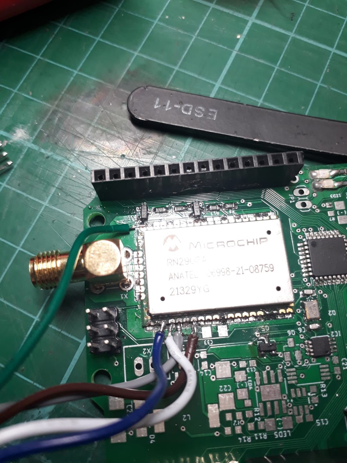

I recently got my PICV3 Kit from this link and soldered everything up according to the RN2903 datasheet as well as this guide.
Soldering

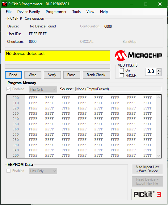

PICKitV3 utility:
PICKit cannot connect

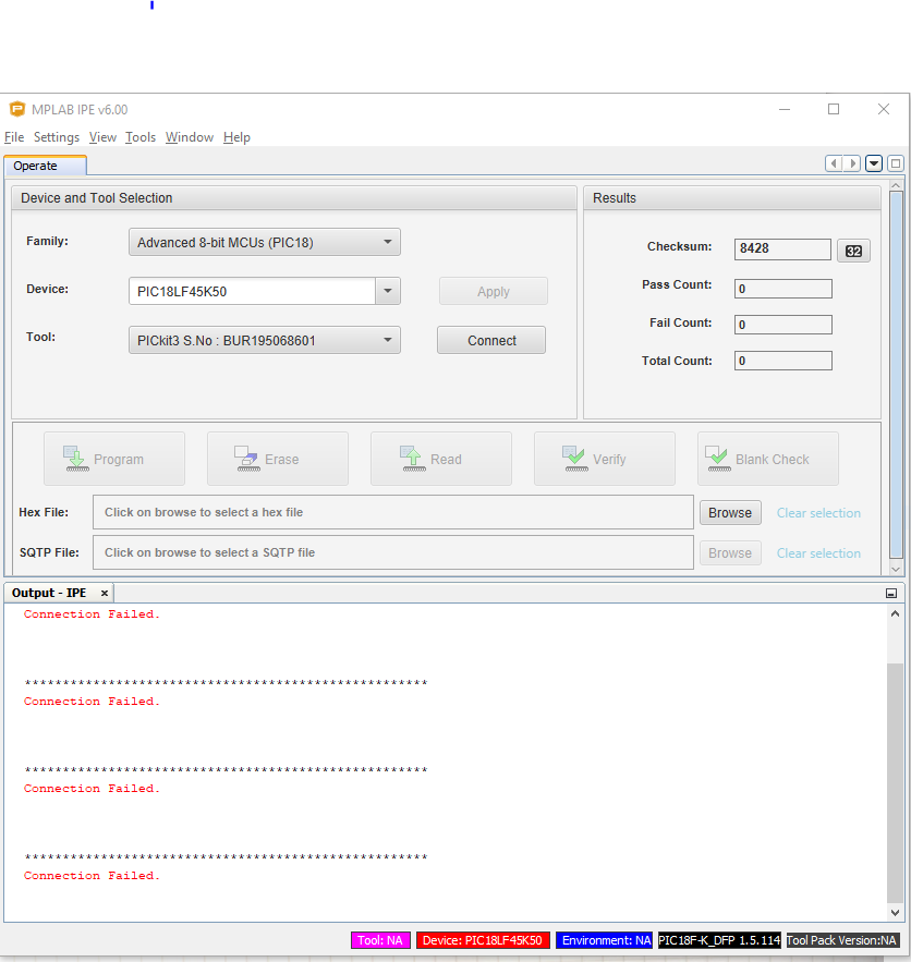

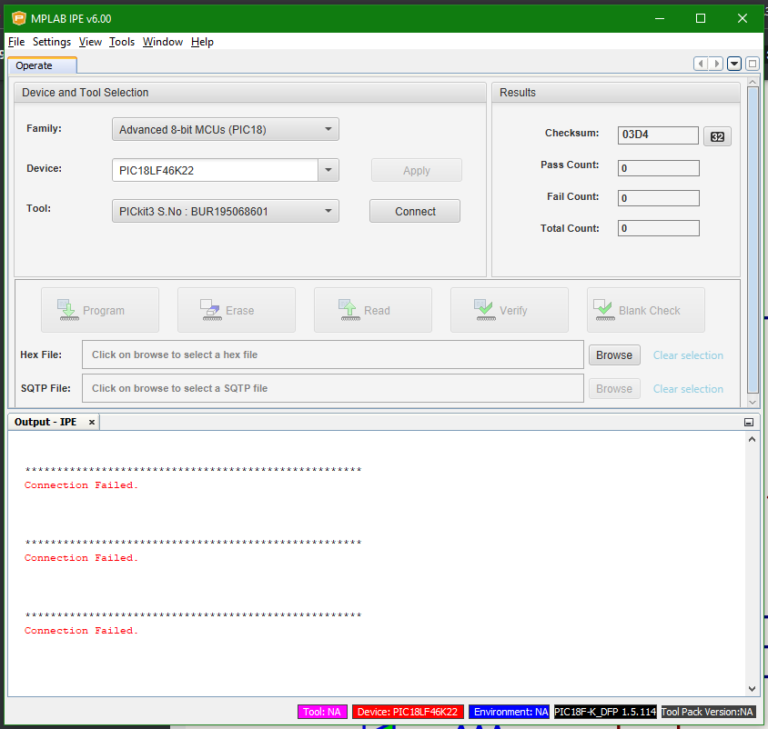

MPLabXIPE:
MPLAB IPE also cannot connect (LF45K50)
MPLAB IPE also cannot connect (LF46K22)
Tried both LF45K50 and LF46K22 but to no avail.
Perhaps I will order the different model next time and design a PCB with proper ICSP breakout headers so I can eliminate the potential errors in soldering but I checked the connections with a multimeter several times and there was continuity…
Oh well for now I will just chuck this RN2903 aside in favour of a RAK3172
