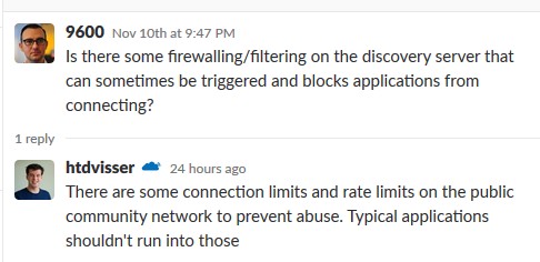

Is there some firewall on the discovery server that can be triggered and results in clients being blocked?
I now have two hosts, in different countries, that can no longer connect to:
discovery.thethingsnetwork.org:1900
I’ve just gone and moved the whole application stack from one host to another to resolve this after connections from the first were being blocked, and now it’s happened on the second.

It strangely started working again on both last night. The hosts are with Hetzner (DE) and Bytemark (UK). Hetzner checked things out and confirmed zero filtering at their side. nmap showed the state as filter, so must have been dropped at TTN end, else en route. Former seems more likely, as other hosts in the same datacenter could connect fine…
Hopefully just a blip.

related FYI
limits
