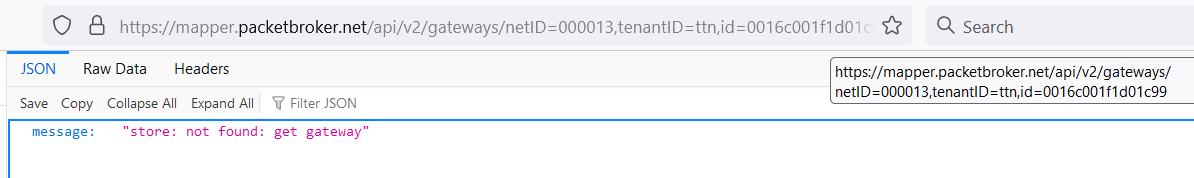

eui ? as neither version appears to exist in the system:-
(though its late and likely that is me doing incorrect/incomplete search!) what have you used as the GWID on the TTN console (not GWID on GW GUI/firmware) - this can be freeform text (see the (?) mark).
