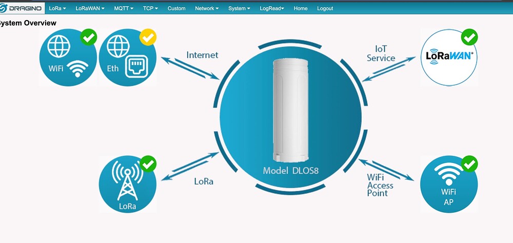

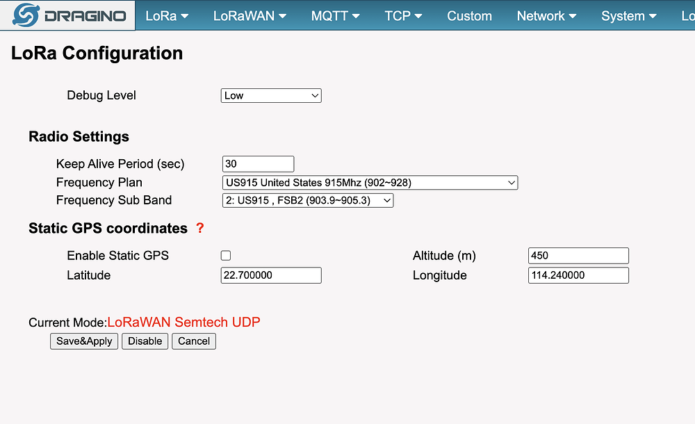

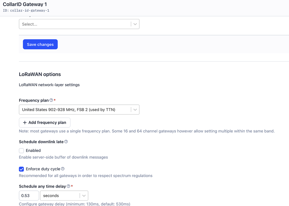

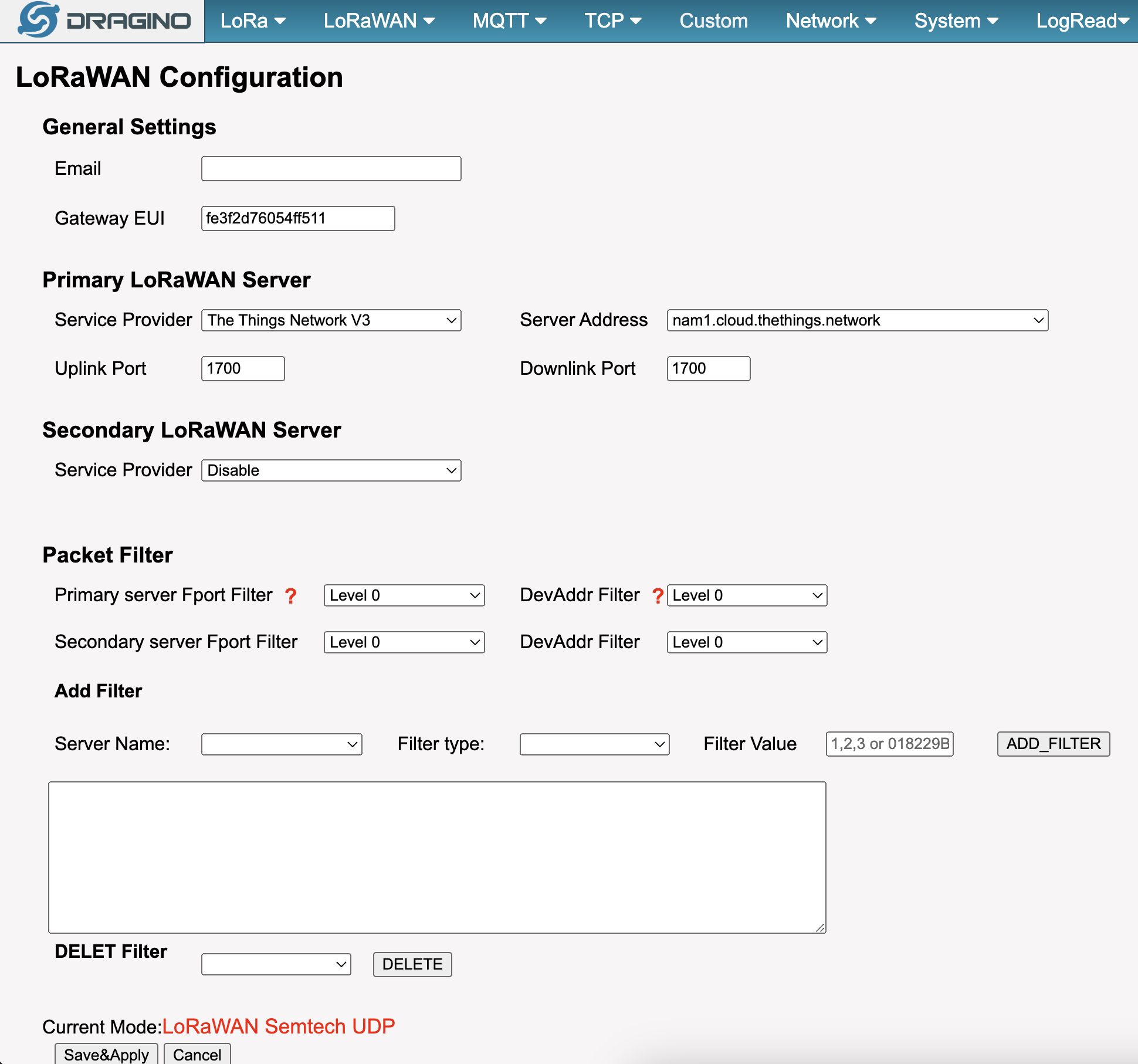

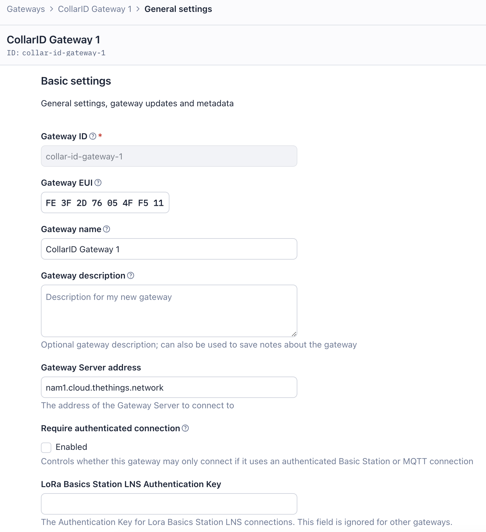

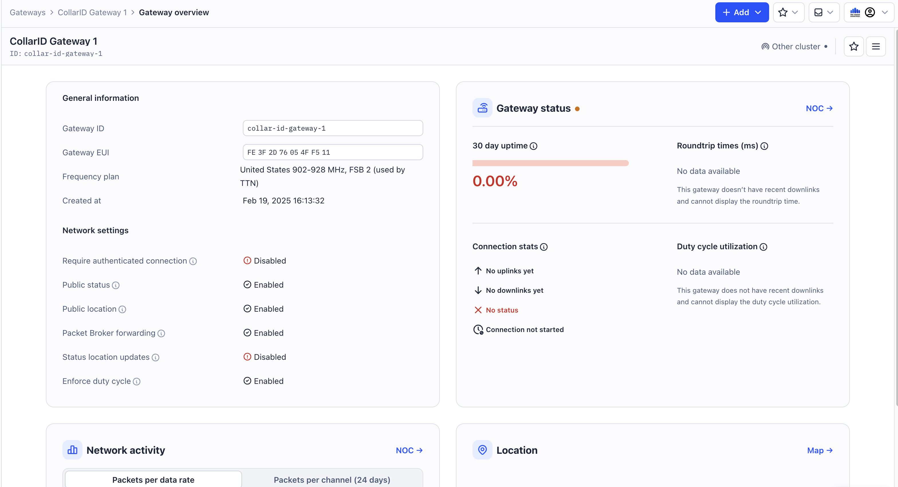

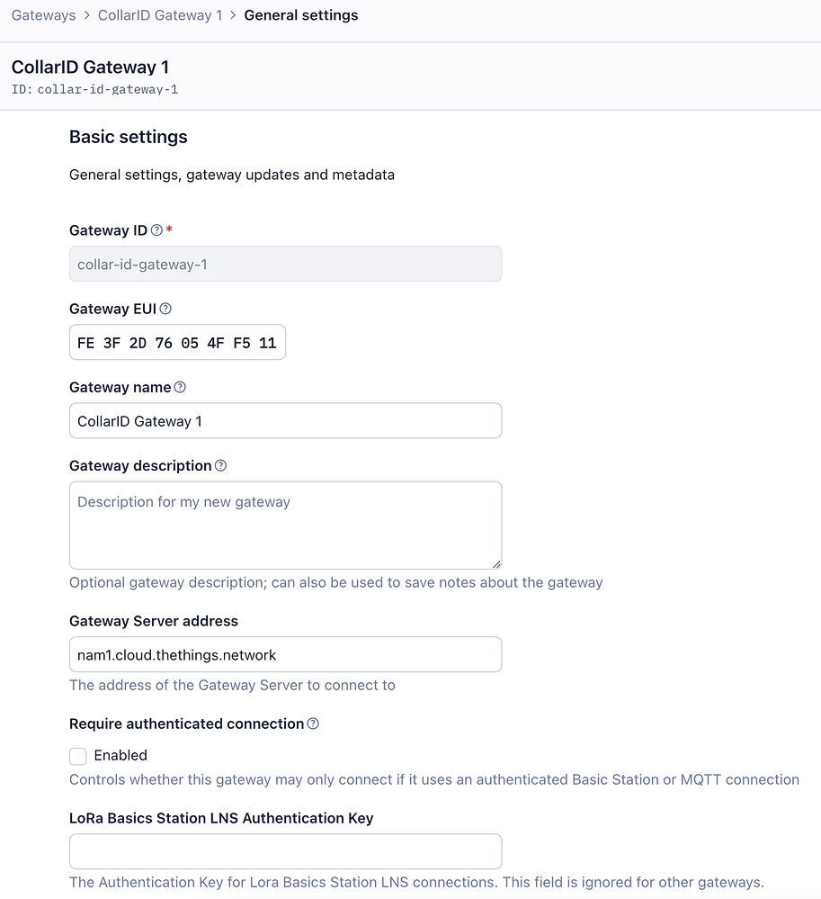

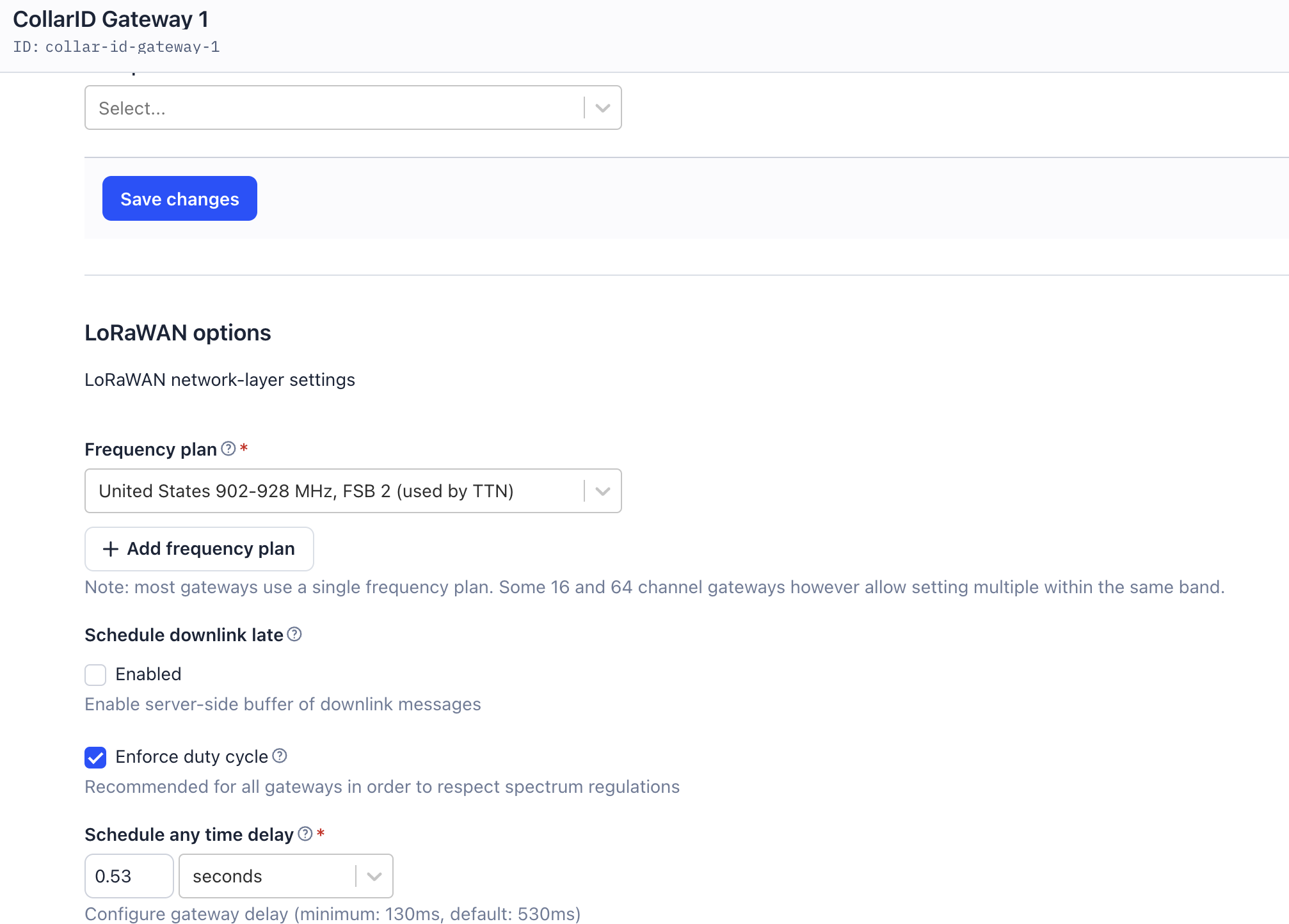

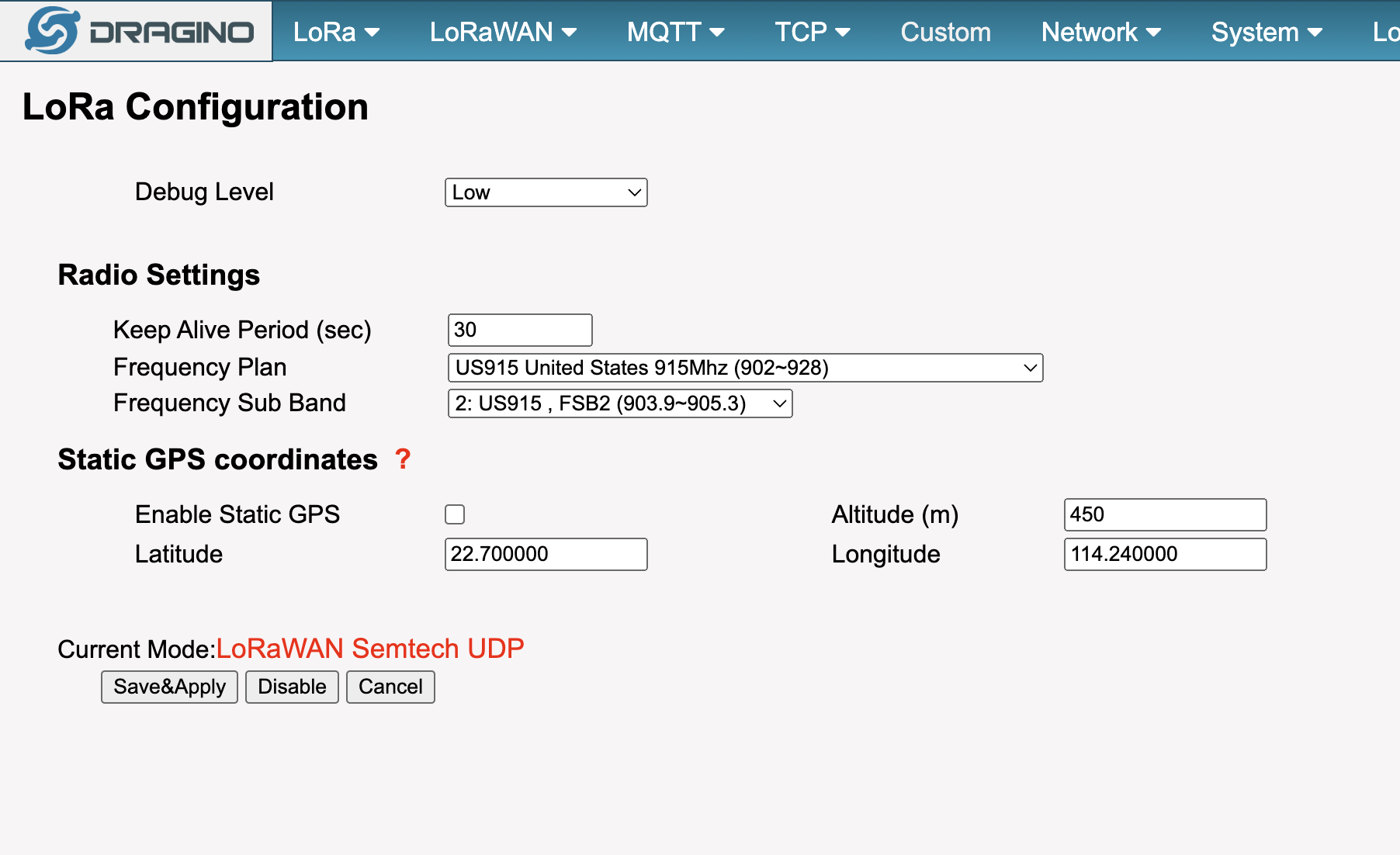

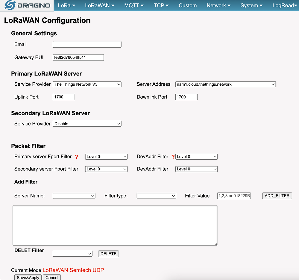

I’m trying to connect my Dragino DLOS8N gateway to a TTN server but I’m not receiving any uplink messages. I followed the instructions here to set up the gateway and the server. I have the gateway connect to my mac via ethernet, and also connected it to my WiFi as a WiFi WAN Client. The LoRaWAN and TTN configs are below. The LoRaWAN looks fine from the gateway UI, so not sure why nothing is being received on the TTN server.

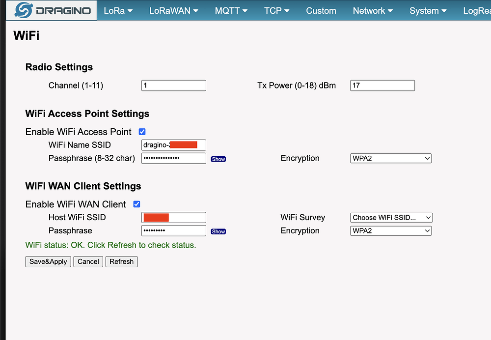

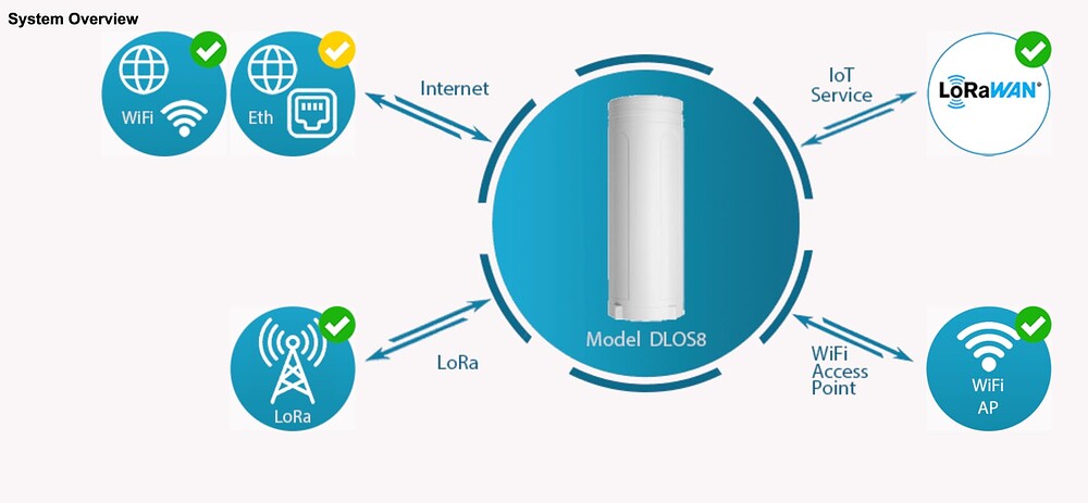

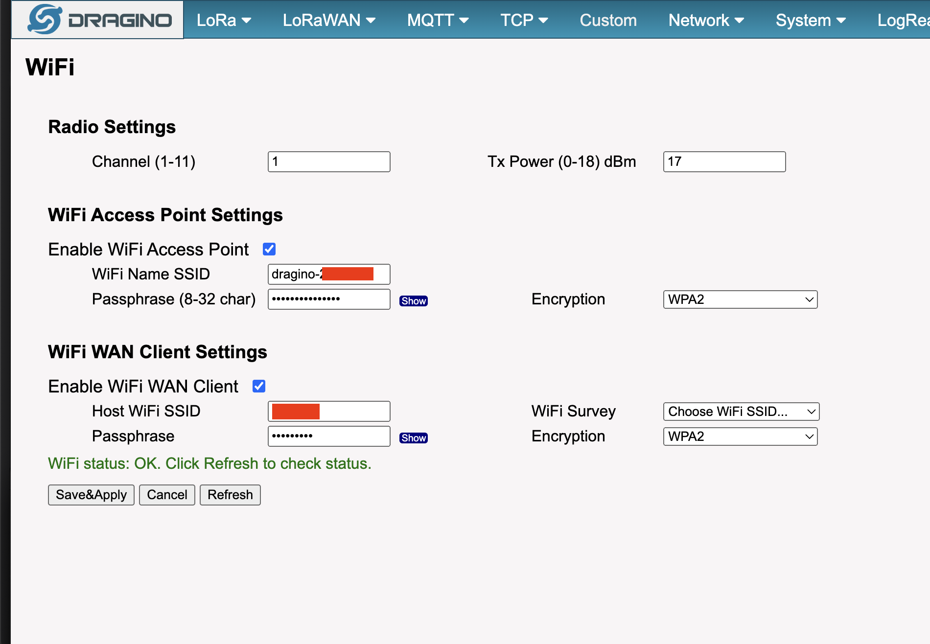

This is my WiFi tab. I don’t have direct access to the router, so I’m connecting the gateway to the WiFi as a WAN client. The gateway isn’t connected to the WiFi through the ethernet cable, but I’m using the cable so I can open the gateway UI on my mac. I still need WiFi access on the mac while I’m connected to the gateway - is there a way to monitor the gateway without the ethernet cable or connecting the the gateway as a WiFi AP?
Thank you both!
It appears you are connecting to/from the gateway in three different ways - the poor thing won’t know which way to look or send traffic - if memory serves it will try to access through the ethernet as a priority - which will then disappear inside your Mac as that is very unlikely to be setup to do any form of NAT or routing.
As you appear to have WiFi and you appear to be able to setup the gateway on WiFi, turn off the AP and unplug the ethernet cable. You can then access the gateway’s web console, if you actually need to, most of the time we don’t, via its IP address. If you don’t know the IP address, try LanScan, a free app that will scan your lan and report on what devices are around.
