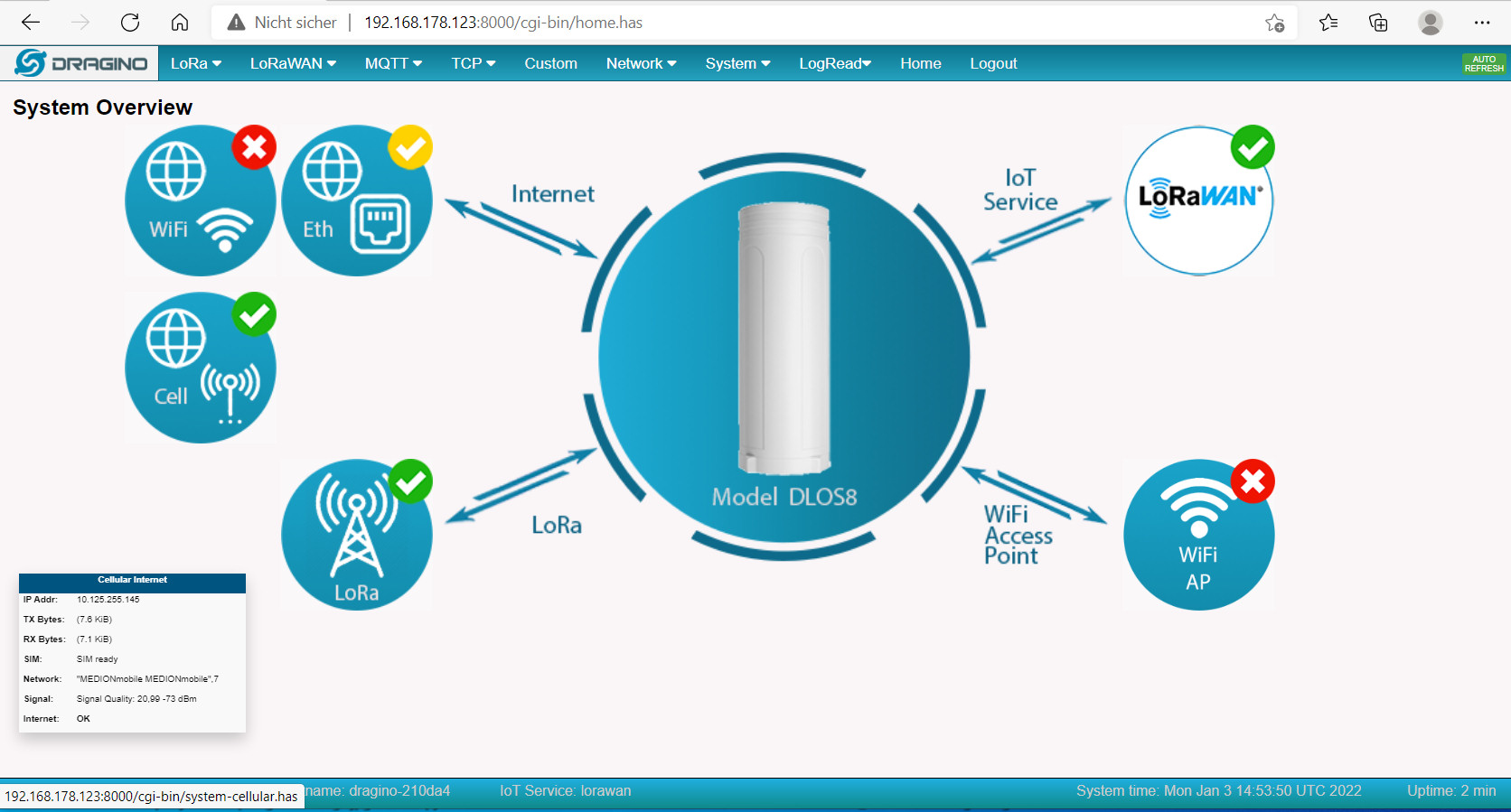

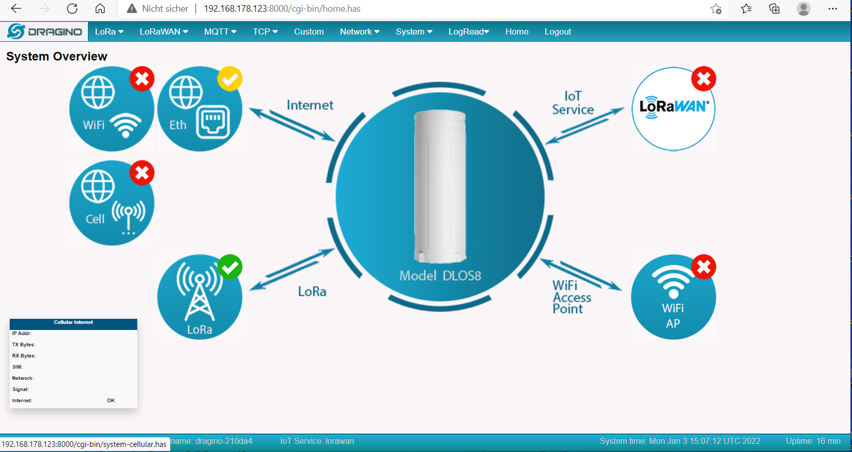

January 3, 2022, 3:18pm
#6
Hello, today i changed the sim from Vodafone to medion (alditalk), the same behaviot.
It worked fore samo minutes, then connection is lost!
Greetings
