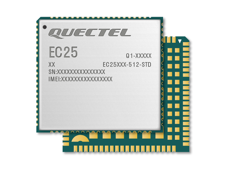

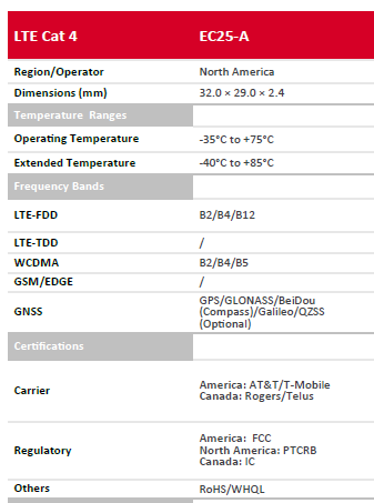

Haven’t got one/used one myself, and not NAM based but IIRC the TTOG US version uses a Quectel EC25-A Mode 4 LTE modem, with fall back support for 3G/WCDMA, data here:
It supports a number of WCDMA and LTE FDD bands as installed in the TTOG, the only thing it doesnt support in that config, again IIRC, is LTE TDD. The EU version EC25-E I believe supports the latter, as well as, from parocial UK perspective :slight_smile: the B20 Band under FDD. What are AT&T claiming to support in the deployed area (turn the question on them :wink: )
Updated to add:
TTOG US supports LTE FDD in B2, B4 & B12, WCDMA in B2, B4 & B5 if that helps discussion…
Thank you for the response and the spec sheet!
The modem in the US TTOG looks like it is the EC25A based on the datasheet and what is displayed in the WAN Status screen. Interesting that the datasheet specifically indicates it is certified with AT&T. Unfortunately when I talk to tech support I don’t think either party is knowledgeable enough to argue these technical details. They simply fall back on the position that it is not working so it is a non-compatible device.
