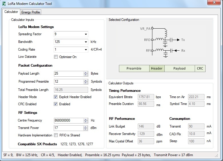

The specification I used were
According to calculations time on air is 222 ms. So this should be the delay between switching from Tx to Rx mode right?

Header Disabled
Why?
And how did you get to 222 ms? If that’s 25 bytes application payload (plus 13 bytes for the LoRaWAN header, so a total of 38 bytes), then the time-on-air for SF9 is 267 ms. Or, if it’s 25 bytes total, so 12 bytes of application payload, then 206 ms.

I forgot mention that header was enabled. I got my values based on LoRa calculator:
I understand that this might vary a little for HopeRF but principally this should be right.
