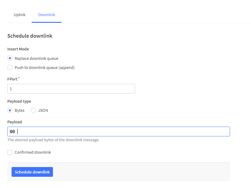

Then, I tried using the downlink scheduler directly from the application frontend. I tried sending payload 0x00 to test a basic approach. Same problem, it printed incorrectly in the console 0x49, see screenshots below.

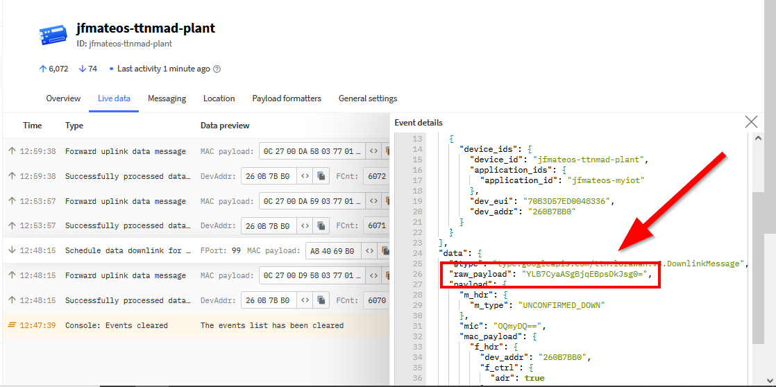

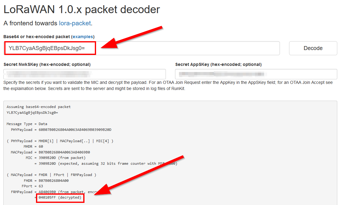

What’s shown on the console is the encrypted payload.
You can use this service (https://lorawan-packet-decoder-0ta6puiniaut.runkit.sh) to decode the raw_payload of your downlink:
imagen
imagen
