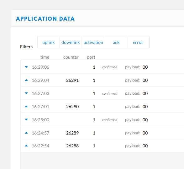

I don’t get this, it looks like device recieves downlink but doesent confirm it? or is trying to confirm to gateway out of react atm?
Screenshot_20190504_162952

I had the same problem using ttgo v1. The device was not able to receive downlink but was sending uplink without problems. I used the same code on two different devices and it was working on one, but not working on the other one. Maybe you try your code on a different device. The message in TTN only means, that you send a downlink with the confirmation request. It does not say that it was well received. The green button ack is missing.
yup… It was signal problem. I added bigger antenna and now it’s ok. (it’s in a bunker two miles away from concentrator). But I also don’t get it… it has strength to send signal, and all 4 my concentrators can hear it well… but cannot recieve it…
