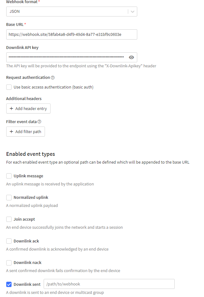

I have tried creating a webhook but I am not really sure how to configure it.
I am using OTAA for this instance if that makes any difference.
thanks
Has it changed in the documentation?
The web hook is fully documented as well but is for sending outgoing messages from TTS, so the downlink sent checkbox will be a message say that a downlink has been sent. The ONLY part of a web hook that refers to queuing a downlink is the inclusion of a downlink API key for you to use.
