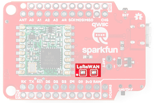

A Sparkfun SAMD21 pro (see here), an arduino-like device that uses LMIC library in its sketch.
