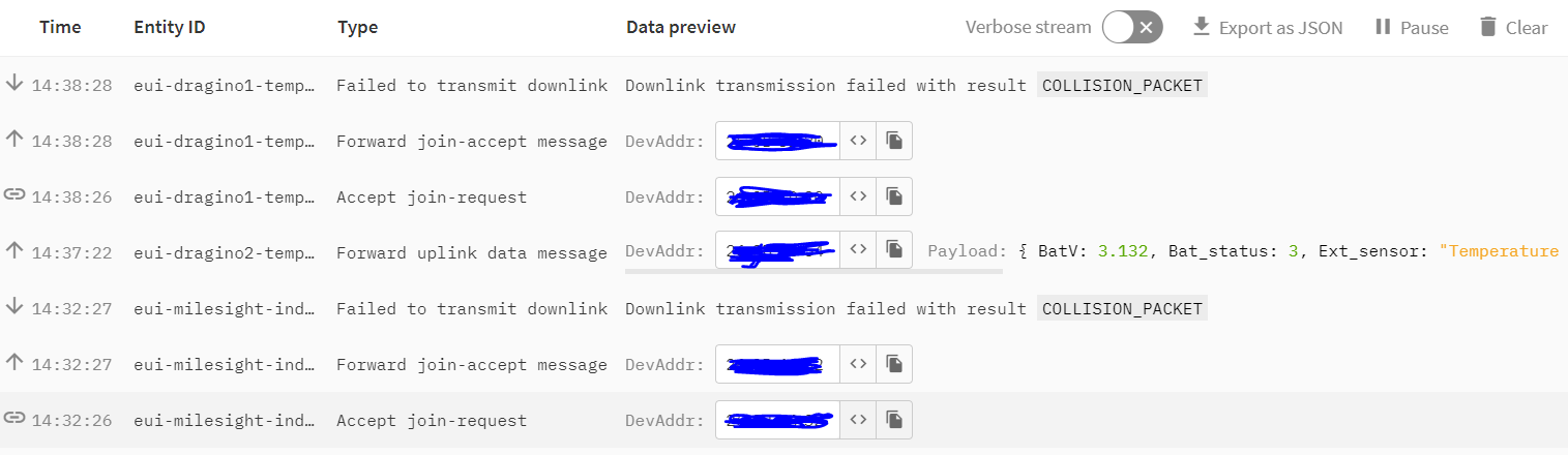

In my application I have 3 devices. In 2 of them I got the same error: Downlink transmission failed with result COLLISION_PACKET while the other device process correctly the downlink information. Does anyone know what is going on?
A gateway has one transmitter so paraphrasing Meatloaf, two out of three are bad.
Try turning the devices on one at a time rather than all at once.
