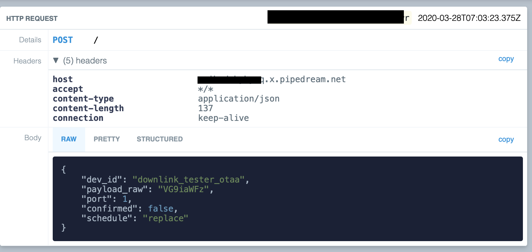

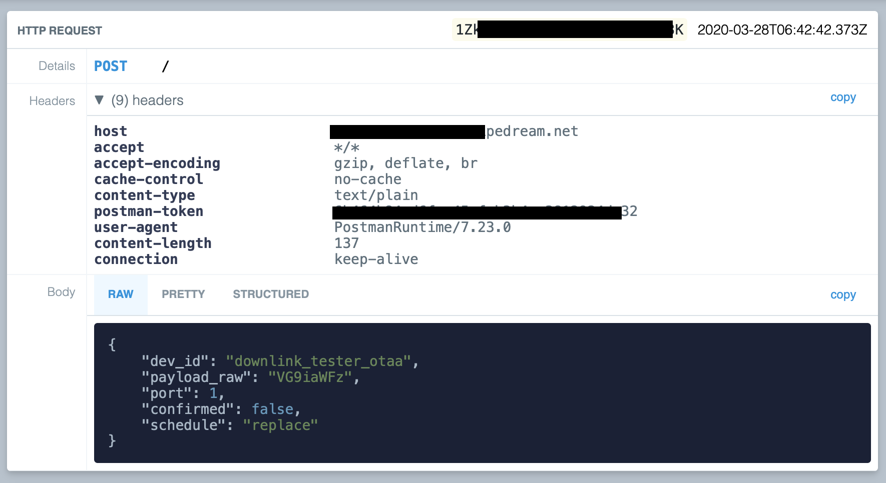

I set up an Application in TTN with an HTTP Integration. Data forwarding from TTN to Blynk works fine. Now i want to go the reverse way. Putting the Downlink-Link in Postman (POST method and data in JSON format in the body) gives me proper downlink initiations (i know, only 10 per day). But doing the same in Blynk results in no action in the TTN console. For testing i made both (postman and blynk) send data to requestbin, to see what traffic and data actually is arriving:
Postman (successful downlinks):
Bildschirmfoto 2020-03-28 um 07.56.16
Blynk (not showing up in the ttn console at all):
Bildschirmfoto 2020-03-28 um 08.03.37
any ideas why this is not working? Changing the content-type in blynk doesn’t help either. Requestbin says in the latter case: content-type text/plain; charset=UTF-8

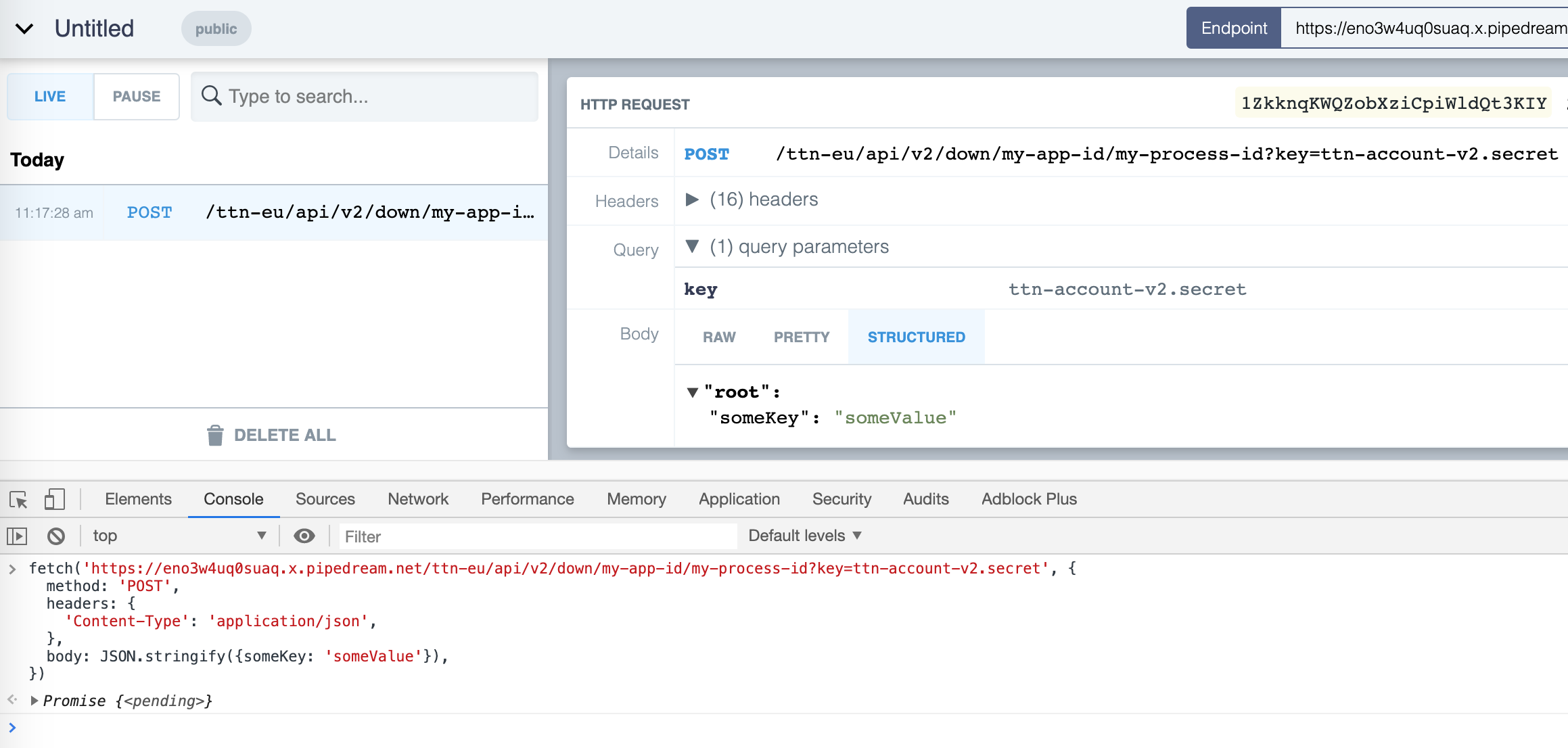

It’s about adding the URL path and (above all) the query ?key=... to the URL that Blynk uses to make the request. Without Blynk, that works fine for me; a POST to https://eno3w4uq0suaq.x.pipedream.net/ttn-eu/api/v2/down/my-app-id/my-process-id?key=ttn-account-v2.secret nicely shows:
fetch('https://eno3w4uq0suaq.x.pipedream.net/ttn-eu/api/v2/down/my-app-id/my-process-id?key=ttn-account-v2.secret', {

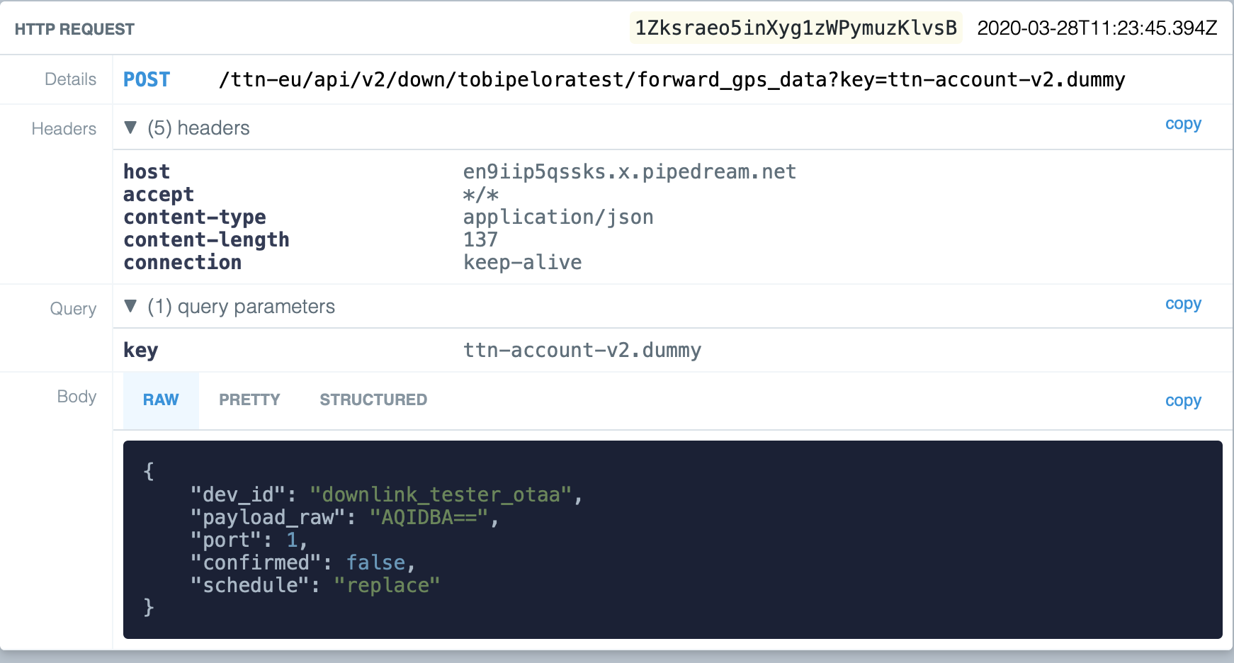

RequestBin POST works.
https://ReqBinID.x.pipedream.net/ttn-eu/api/v2/down/tobipeloratest/forward_gps_data?key=ttn-account-v2.dummy
Changing it to the following doesn’t (“dummy” replaced by correct data of course):
https://integrations.thethingsnetwork.org/ttn-eu/api/v2/down/tobipeloratest/forward_gps_data?key=ttn-account-v2.dummy

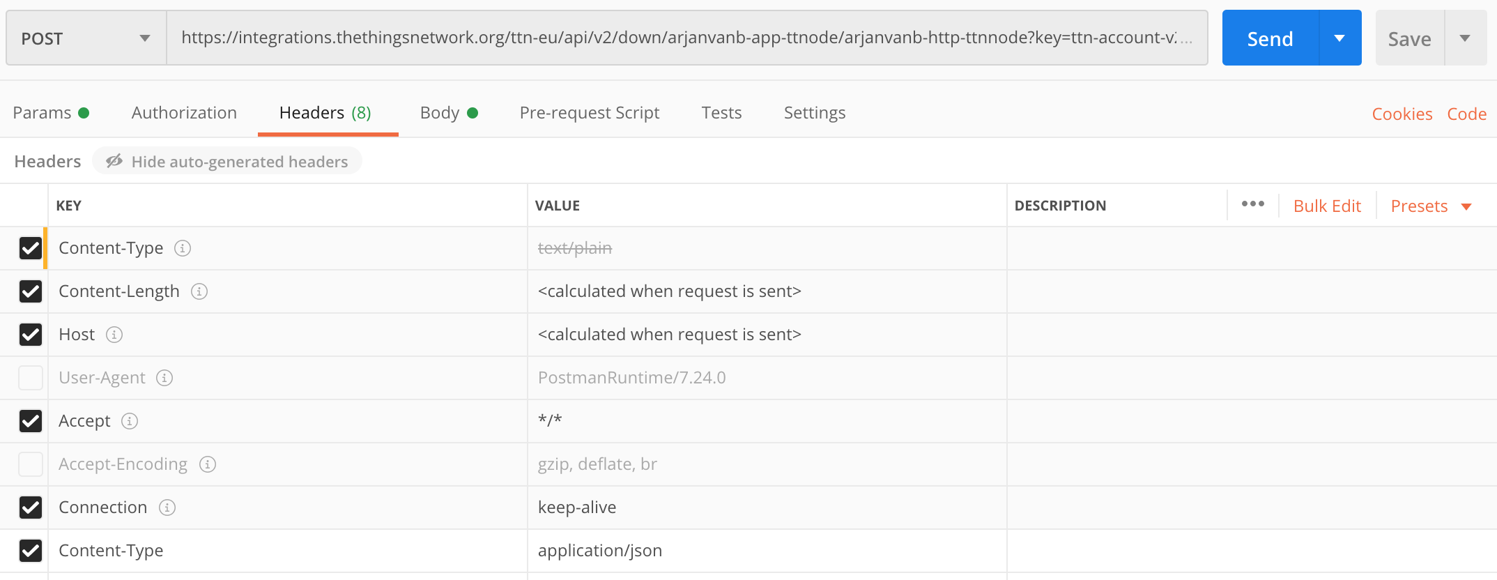

Some testing shows TTN doesn’t care about a missing User-Agent. The following (along with disabling some headers in Postman’s preferences) creates the same headers as shown in your RequestBin tests, and works just fine in TTN:

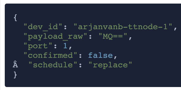

Also, it seems that RequestBin shows UTF-8 encoded non-breaking whitespace, which would also increase the Content-Length which does not happen for your tests:
non-breaking space
