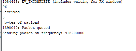

Hello everybody excuse my english, I use the lora 32u4 ll to do uplink it´s works but when i tried to recibe the data (downlink) it never enter to this code:
if (LMIC.dataLen) {
Serial.println(F(“Received “));
Serial.println(LMIC.dataLen);
Serial.println(F(” bytes of payload”));
somebody knows what happend ?

Hellow cslorabox, thanks for your answer, I view some similar postbut i tried to do the same accions and It dont works in my serial monitor I can see the uplink message and in the server the data arrives, but I dont recived nothing in the downlink.This is mi serial monitor
