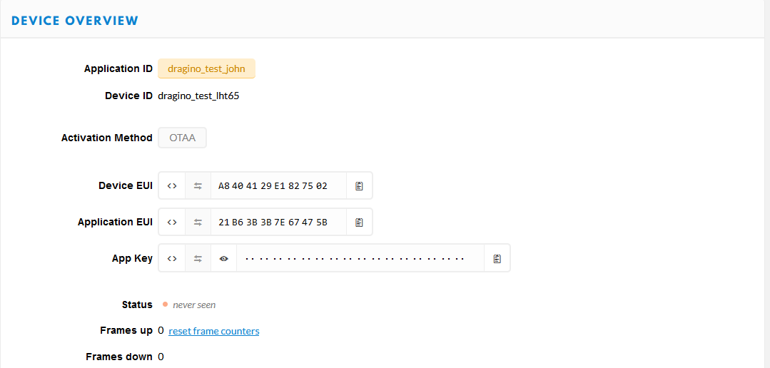

I am newbie with the Lorawan technology. I bought a dragino LHT 65. I follow the steps to join lorawan network with the user manual:
but blocked at the “Step 2”, the device LHT65 do not join automatically the TTN network. I try to connect the device (hold Act button for more then 3 sec) the led flashes several times green , then red with 15 sec repeating time. And after 10 minutes or so no flashing led anymore. I never see a blue flashing led.
here is the setting in the thethingsnetwork:
what is the problem ?
the device Dragino lht65 do not connect to a gateway ? Dragino LHT65 need a gateway to connect? Personnally I do not buy a gateway.
there is no ‘free’ gateway ? the device is set up in Paris.
Please help!
Thank you

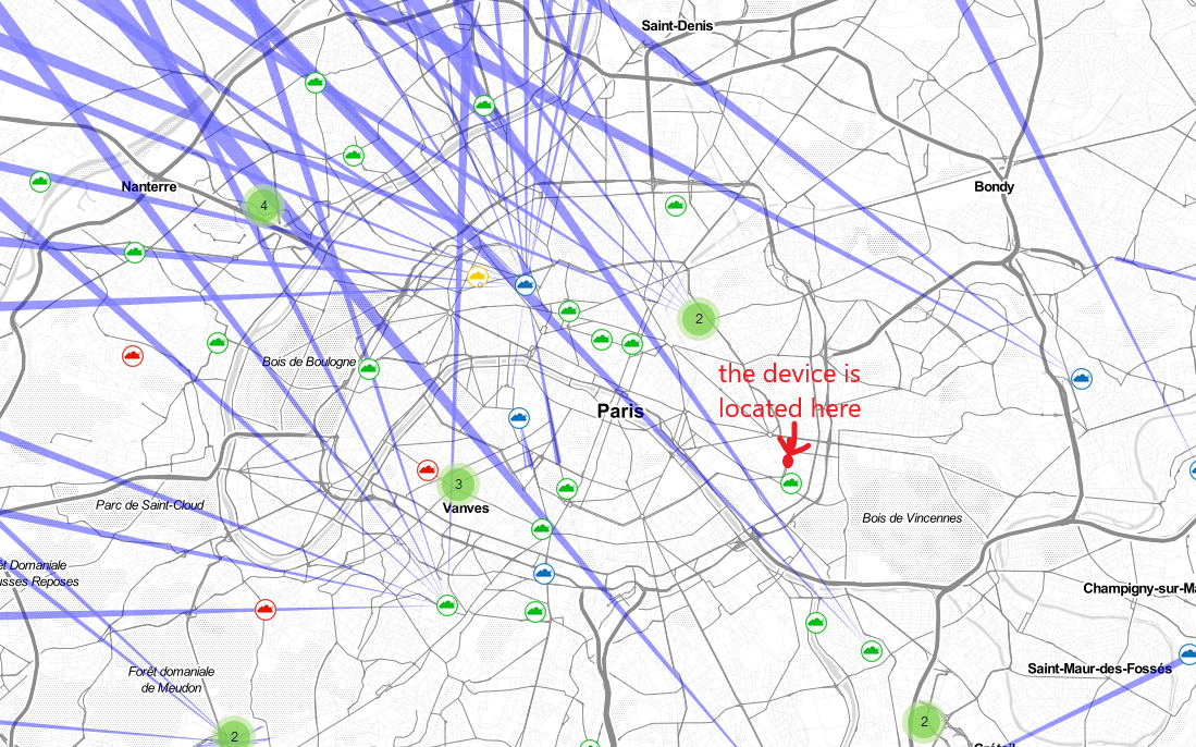

Hello,
i checked the coverage,and i see that a gateway is nearby. dragino location 1
normally I could connect, couldn’t I ?
thank you
Best regards

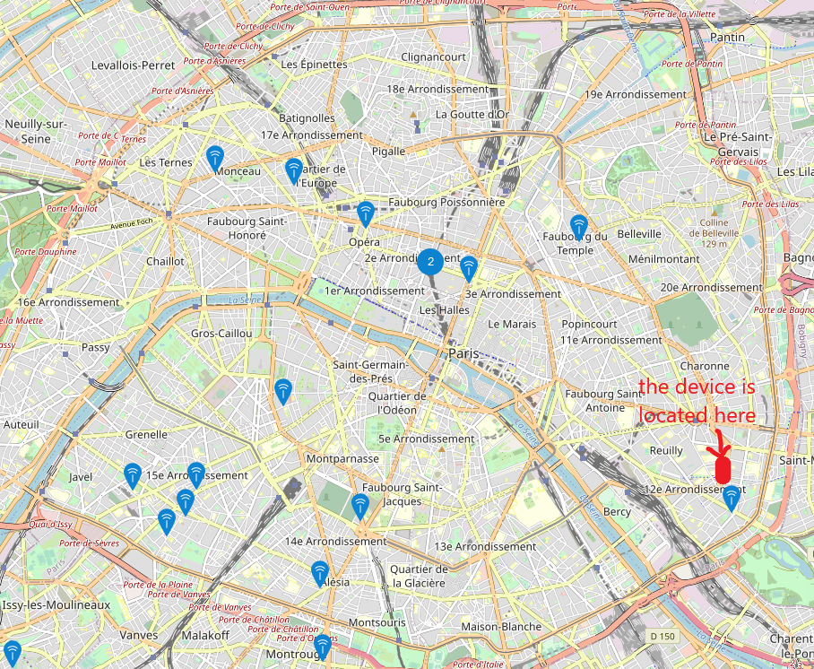

Hello,
with https://www.thethingsnetwork.org/map dragino location
thank you
Best regards

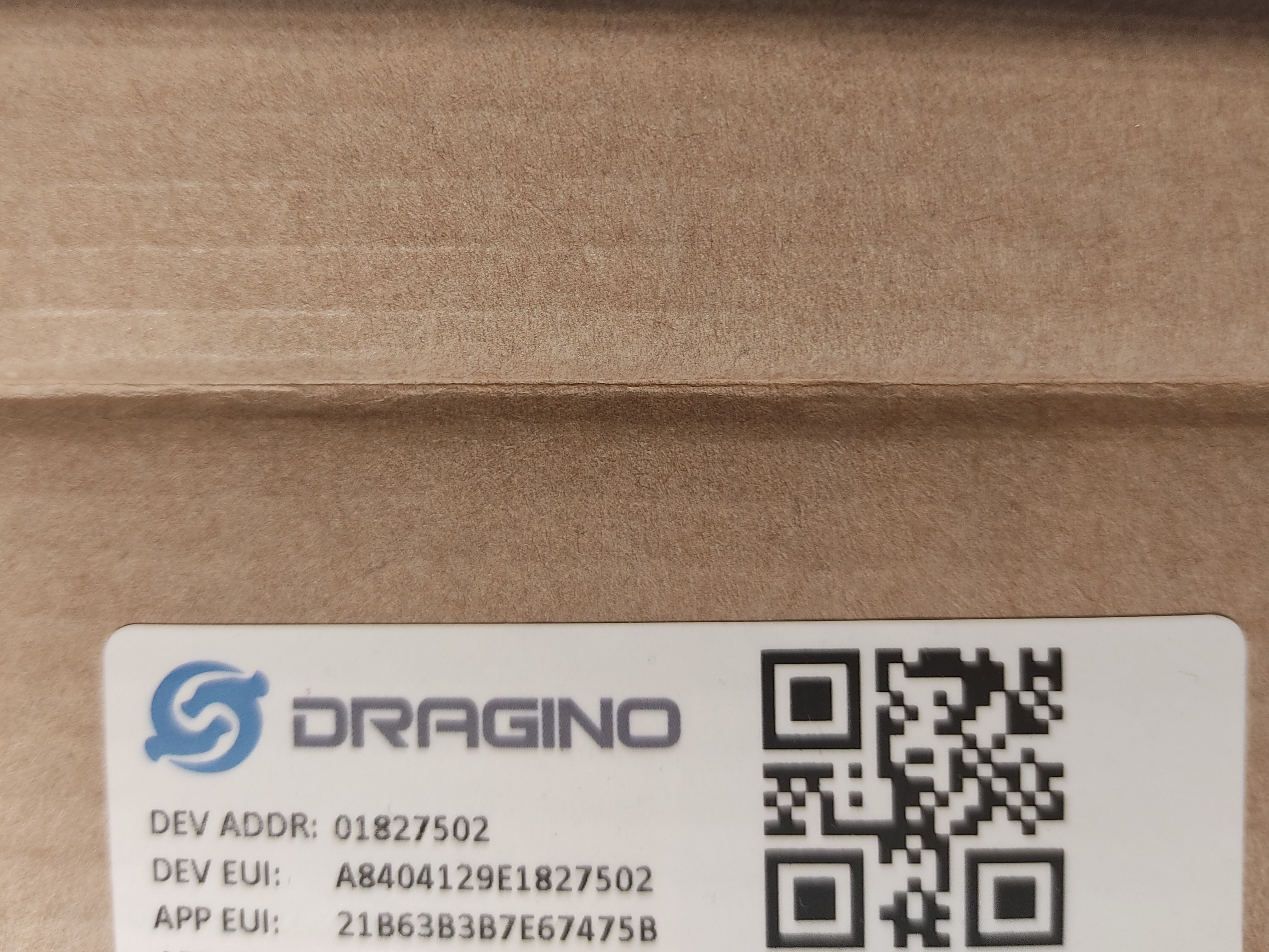

I verify twice that the settings App EUI, DEV EUI, APP KEY are the same than the provided Label in the packaging. So I think the problem does not come from settings information.

But according to https://www.thethingsnetwork.org/map, there is a Gateway, maybe not free ?
So, i do not understand the issue.

Your screen shot shows otherwise.
Gateways can handle 1,000’s of devices.
PS, We are THE Things Network. Not One Thing Network.
Strange, I’ve got four LHT65 devices and for all of them the AppEUI starts with A8 40 41 which is registered to Dragino,
Of course we all know @kersing meant the Dev EUI.
The instructions say the App EUI should start 3F 77 AD. Your screen shots says you have 21 B6 3B
No, I meant AppEUI. Dragino assigns both AppEUI and DevEUI from their own range.
Curious, the instructions show Dev EUI starting A8 40 41 and App EUI starting 3F 77 AD
Hello,
here is the photo of the label IMG_20201109_174419
I just checked one of mine close by and my Dev EUI is also A8 40 41…

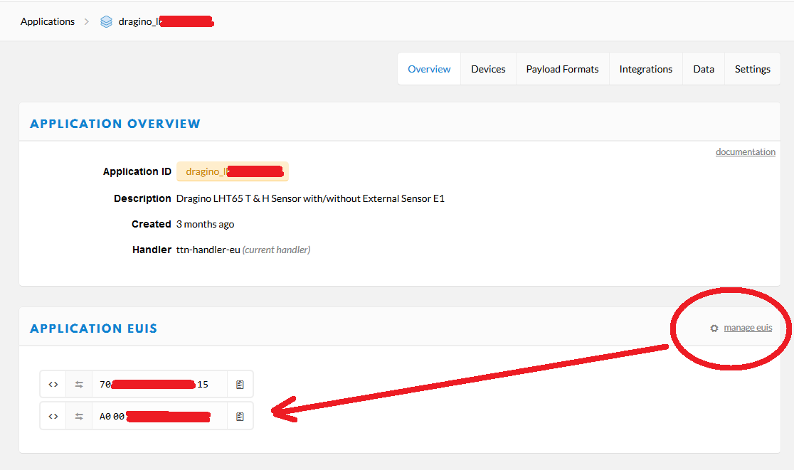

In another of the reuse of App EUI cases (I suspect) looks like mine starts A0 00 00…
To get it up and running (IIRC) I just used the ‘Manage EUI’s’ setting in App console to add the A0 00 00 … as alternate to system generated App EUI and it worked just fine. But then I think I’m running an earlier firmware version (1.4.x/1.5.x?) ?) - would need to go check. OP may find differing firmware versions may well behave differently that the instructions for the v1.7.3 build, but unlikely…for a time there were many older versions out in disty stock…

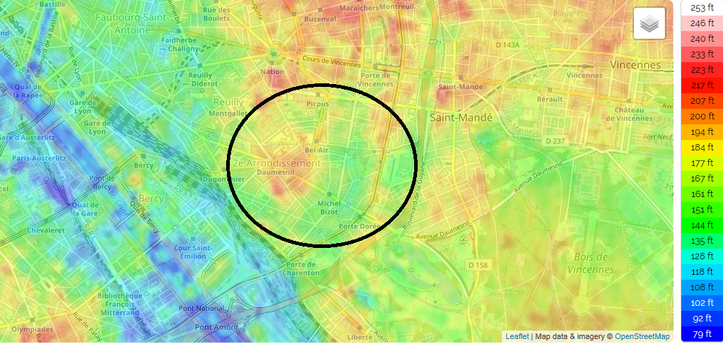

Difficult to tell likely local RF environment however I would note this is quite dense urban and map doesnt make distance clear but must be 400m-1km to (supposed - may not be actual) location of GW, with high rise blocks, multi-story car parks, self storage units, housing, office, supermarket and other building clutter in the way!
@John_Lion, if it were me I would take node from the approx Boulevard de Picpus & Campus Picpus area back down the Rue de Toul to close by the GW location and reset device, power up & check there (Having checked lable details for 3rd time ofcourse! :wink: ) If still no success take it close to one of the other GW’s in your region as GW may been relocated without being updated on the map! …oh, and buy a GW to improve testing & add to your local community :+1:
It may also be that the local topography is working against you if the GW is set at a low level…would need to know acurate node location to check if you have effective line of sight:
