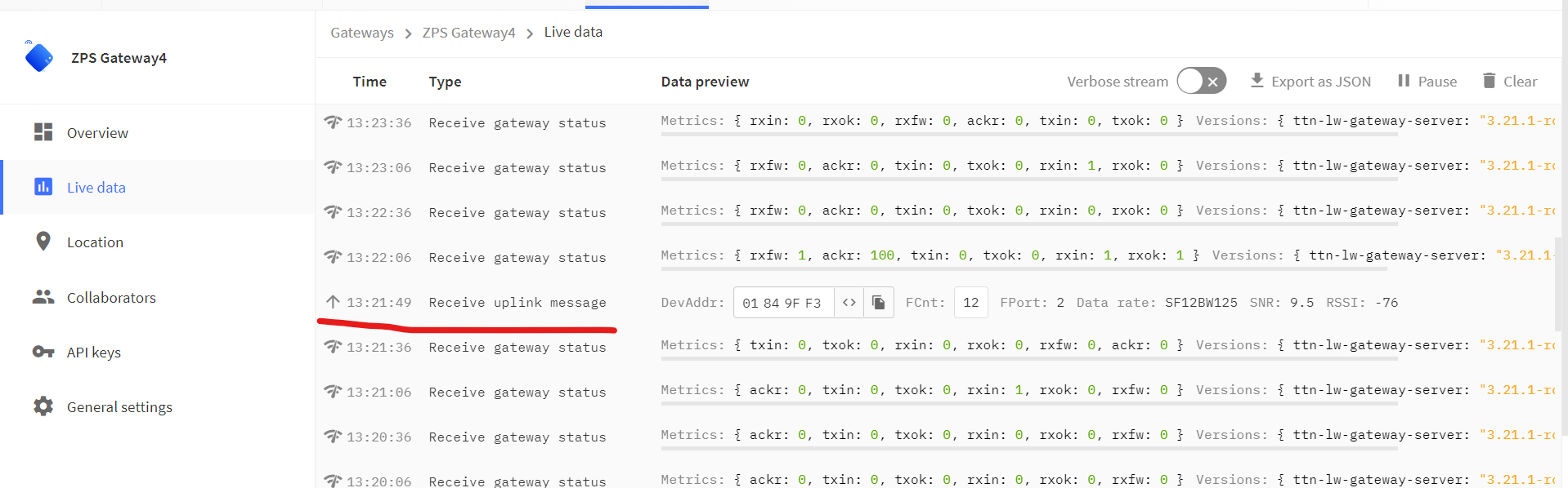

But now I have another problem. My Temprature Sensor from Dragino does not connect to TTN server, although it is alrealdy connected to the Gateway, it can be seen in Log of my gateway. It is also shown in my TTN account (screenshot below). The data from my sensor was entered carefully several times. I did everything according to the instruction of the manufacturer.
Dev addr 01xxx means it is in the experimental range vs TTN allocated block, so assume you have this registered under ABP rather than OTAA? You need to double check device firmware and as registered under application/device console to ensure all keys and device details are a direct match with correct spec/phy option etc….are you seeing anything on the device console page at all? You might also try registering under OTAA (with correct f/w) to see if that works as much of the info is then automagically taken care off without room for wetware errors….:wink:
Thank you for answering, Jeff! I am not so sure about it, what ist the difference and how do I know how I registered it? Below is my Sensor data i entered, and the data shown by the manufacturer. I am pretty sure I entered everything right
Device (or node), a sensor is something that records data that is passed on via a device/node. They are settings. Data is what we receive. LoRaWAN is too complicated to debug without standard terms.
We can’t see any settings from the manufacturer and it would help tremendously if you told us what the device actually is. Only the AppKey needs to be kept secret, Dev & App/Join EUI’s are heard in plain text on the air.
At the top of the page is a link to the Learn section which will tell you LoRaWAN 101 which you will need to survive - you must read this as the difference between OTAA & ABP is a fundamental. Dragino normally provide keys to setup for OTAA so the ABP entry in the gateway log seems a bit odd - which is where knowing what the device is so we can ensure which instructions you’ve used.

it is LSN50 v2-D20, outdoor temperature sensor from Dragino. The problem is solved. I just added the node one more time using Appskey and nwkskey. Now everything works properly, thanks for help
