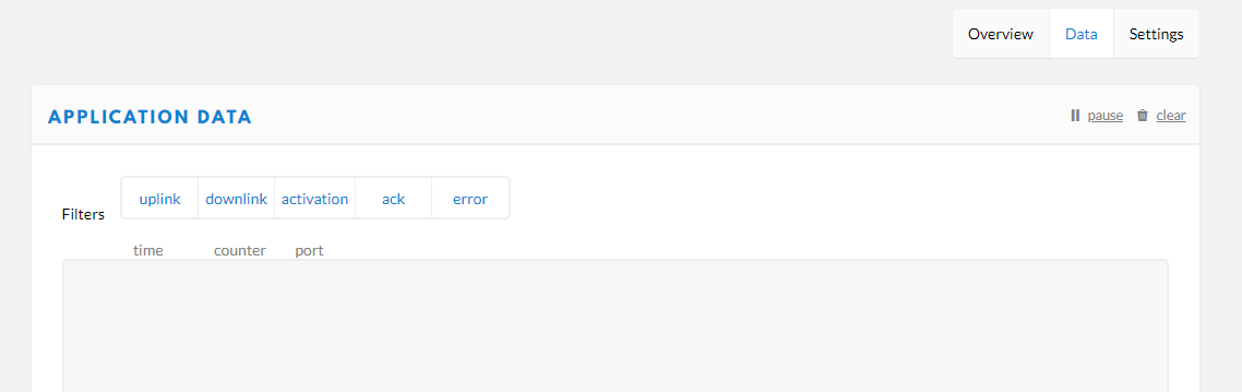

I think I had a first connection of my Dragino node to the TTN. The status of my device changed from “never seen” to a specific timestamp and a few frames counted. Now I want to find which gateway was used to reach TTN, but in Data/Application Data there’s nothing. Was my connection a false positive, or I’m not looking in the right place?

did you create an application first and added your node ?
Application data is not cached/stored. It is a life view only. So you will see data when it arrives only if you have the page open.
yes forgot, Kersing is right, you have to leave your browser window open
Ok understood, I didn’t left the browser open.

Unless you add the free storage integration :slight_smile:
I didn’t know that… tnx, I still learn every day :smiley:
Not all data is the I see, but the payload is
That does not store the meta data like which gateways received your data and the signal levels. Only the ‘message’ is available in the storage integration.
