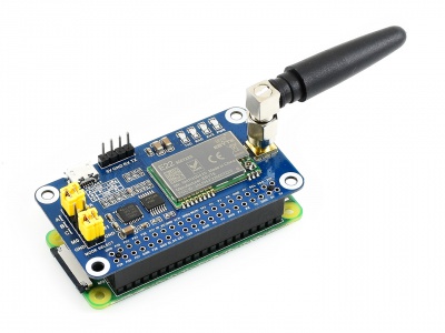

Hey there, I recently purchased “Waveshare SX1262 LoRa HAT for Raspberry Pi 868MHz Frequency Band”. I have the Dragino DLOS8N Gateway. Can I send data to the gateway using this LoRa Hat and Raspberry Pi? Can anyone please suggest possible ways to use this board?

The basic version is LoRa (Proprietary) only and doesnt support LoRaWAN so will depend on which specific module you have bought
see e.g. yellow banner under picture here:

SX1262 868M LoRa HAT
SX1262 868M LoRa HAT\ 400x300
Instruction
  • This product is a Raspberry Pi expansion board based on SX1268/SX1262 chip, a wireless serial port module with LoRa modulation function.
  • With multi-level relay to achieve ultra-long-distance communication, low power consumption wake-up communication, encrypted transmission, etc.
  • This product uses a private protocol and does not support LoRaWAN.
…Even though they go on to discuss both LoRa & LoRaWAN further down the page - potentially confusing!
Their ‘HAT’ version supporting LoRaWAN is apparently actually one for use with the RPi Pico not a standard Pi :

So, I can’t send data to the gateway using these modules mounted on Raspberry Pi 4? By using Pico, I can send data to the gateway! What could be the possible reasons? And are there any other modules available to use as nodes mounted on Raspberry Pi to send data to the gateway?
Not looked in details but think the Pi versions are LoRa only……you need to run a LoRaWAN stack - with somewhat deterministic/hard real-time behaviour hence need an embedded MCU for that rather than the general purpose/Linux base of the PI, but no doubt someone will correct me (not a Softie!). The PiCo of course is based on the RP2040 embedded mcu and I believe there are now LoRaWAN stack ports from various sources which therefore enables a LoRaWAN and not ‘just’ a LoRa node.
There are a number of Pi HATS in the market……these tend to be based on LoRaWAN modules ……running their own internal stacks on separate mcu inside, that typically communicate with Pi over UART/serial and often have +at like commands. (GIYF)
Please do not share pictures that we can see online. Or at least, ensure we can read the writing on the important bits - zoomed in and left to right - volunteers don’t have time to download, rotate & zoom and it’s a multiplicative effort - you do it once or it ends up being down half a dozen times by other people - this does actually contribute to global warming.
But also, why post them at all when you already know that they don’t work with LoRaWAN?
You’ve already been told this. And it says on the vendors website.
Where did you get that idea from? If the Pi can’t send LW, why should the Pico, a much smaller & less capable MCU be able to send? And how do you intend to wire it up?
As @Jeff-UK suggests, a LoRaWAN stack on a Pi is tricky, which is why you don’t see much of it around. And to that end, you’ve been told that that HAT isn’t going to work with LW.
