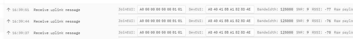

Hi all,
I’m trying to develop my first project in LORA, I already have my gateway working and connect to the TTN, and Im now triyng to connect dragino Model RS485-LN.
Im seeing the connection in the gateway, but in the aplication I only have “accept join request” and i don’t have status of the node.
What does it mean ?
Thank you all.
image.
Usually it means the device hasn’t heard the Join Accept transmission from the gateway.
What is the gateway (make, model)?
If the gateway & device are too close, it can overload the RF circuits and messages get scrambled. Ensure they are 5 or more metres apart - even better, a wall between them.
