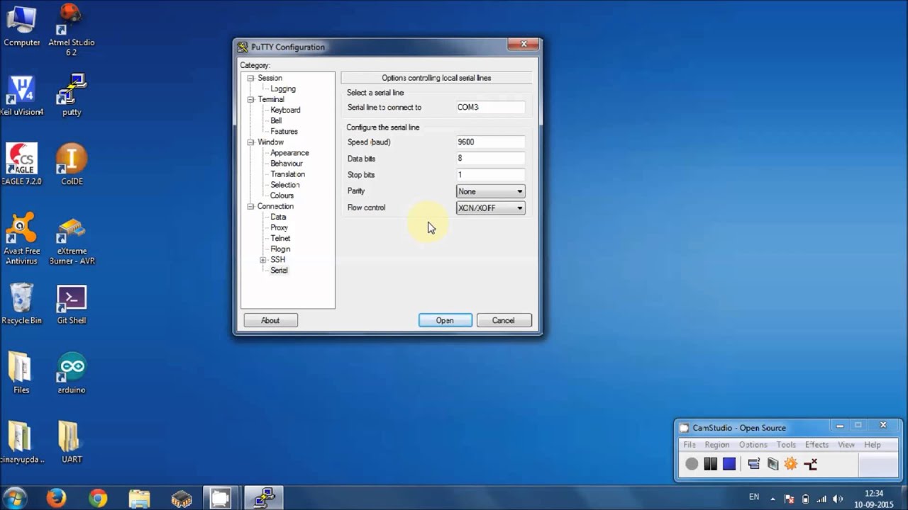

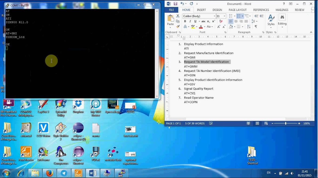

Hello, you can try putty again:
AT Command using Putty Serial
PuTTY-Tutorial für Serial COM
