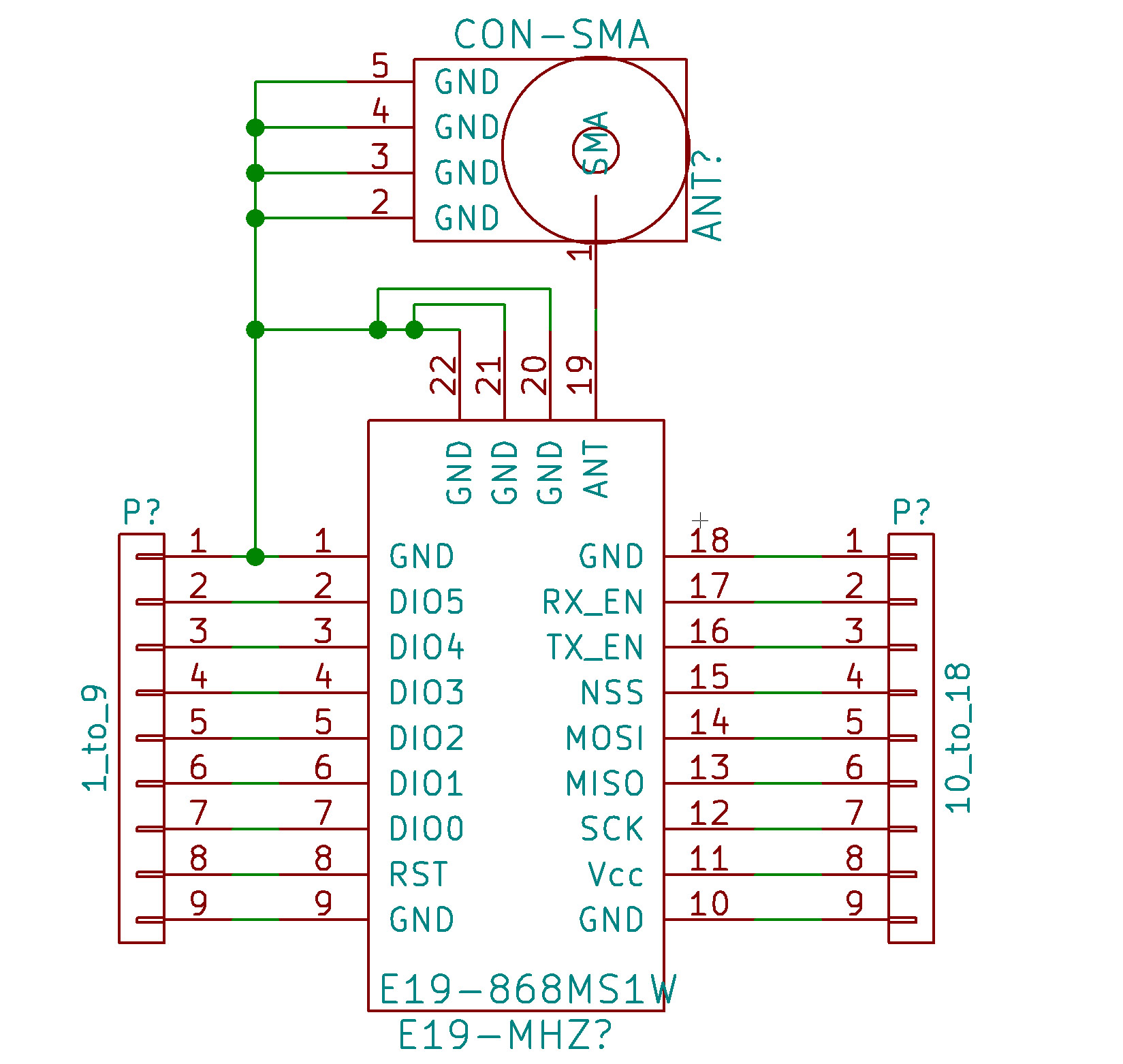

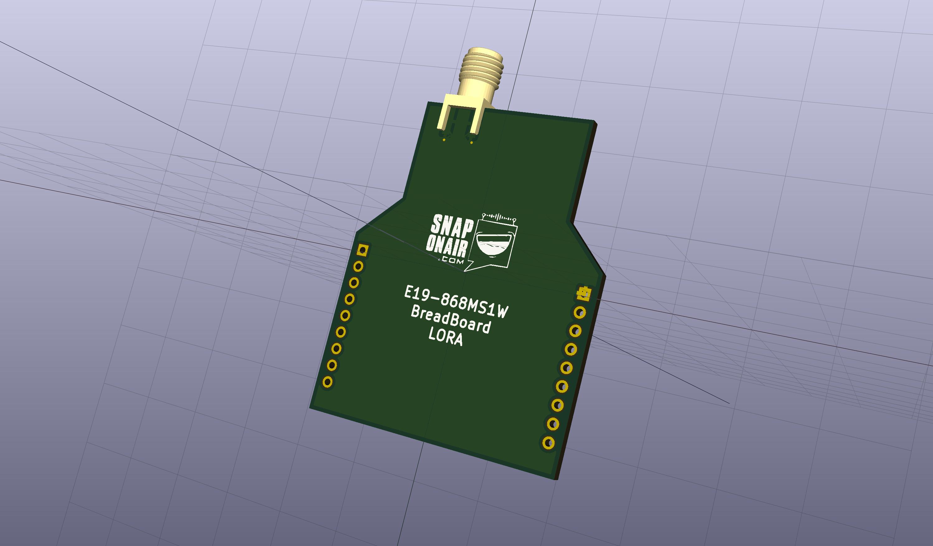

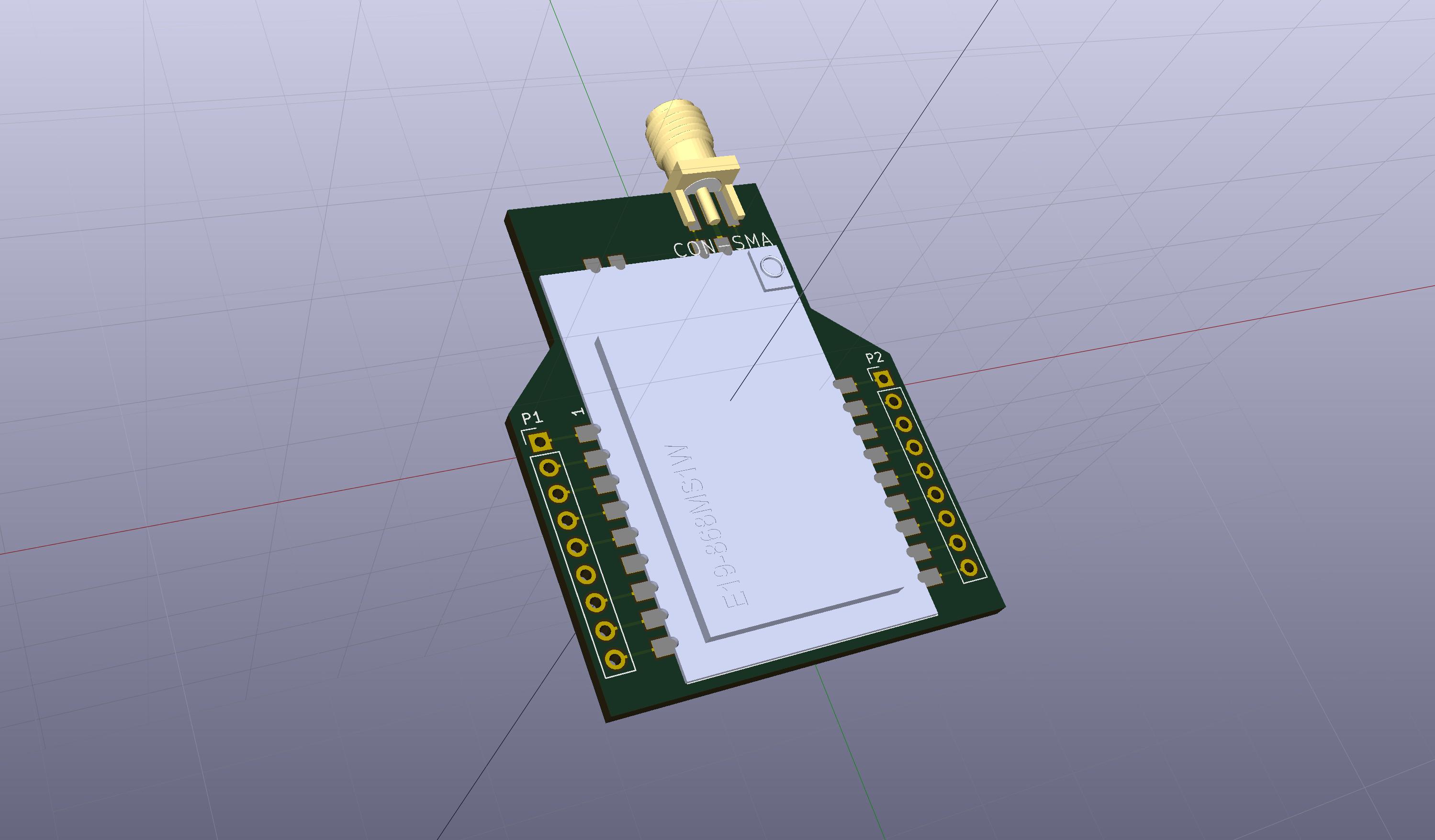

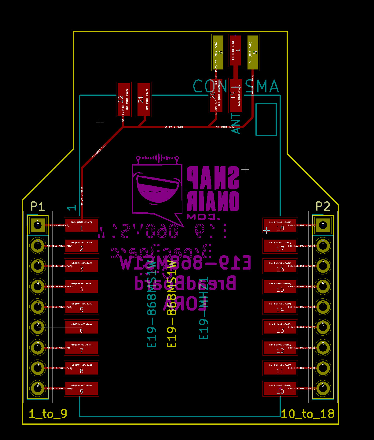

PS: some clarification (I received a few questions): this board is only for experimental purpose and test code.
There is no filtration in this design. Some local restructive regulations allow only 100 mW. Please check before proceeding.
Wow, 1W, that’s one hell of a transmitter. I suppose it could be useful to get the most of installations with long wires… i.e. the antenna is perched atop a radio tower but the node has to be located at the bottom, for some reason.
It’s not exactly ‘low power’, however…
I’ve tested the 100 mW version on 868 Mhz band yes.
For the moment it is LORA ready. I’m finishing the prototype and I’m about to start the coding for lorawan (not sure it is easy).
I have 1W version for 868 mhz but never tested so far.
The concern about the 1W version is, of course legal. There are also other concerns such as harmonic filtration. These devices are so small it is hard , and almost impossible, to add low pass filters. (we need to add them in sandwich in the SMA connector line)
I’m using the 100mW for a couple of weeks now. The transmitted signal seems to be slightly weaker when comparing to a node that is using a RFM95. But that could also be caused by antenna variations. I still need to do a good comparison test.
The biggest difference of this module compared to other SX127x modules that is has separate rx and tx pins. If you want to use it with LMIC that won’t work out of the box. LMIC only supports a combined rxtx pin. To be able to use it, I slightly modified LMIC to drive separate rx and tx pins.
