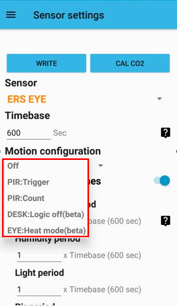

The motion configuration is set to “EYE: Heat mode (beta)”
presence-sensor

I’ve bought recently an ERS EYE Sensor and I would like to test them. However, some features of for sensor configuration are disabled. Actually, i put the motion configuration in Off but still receive a frame with motion :
eye
