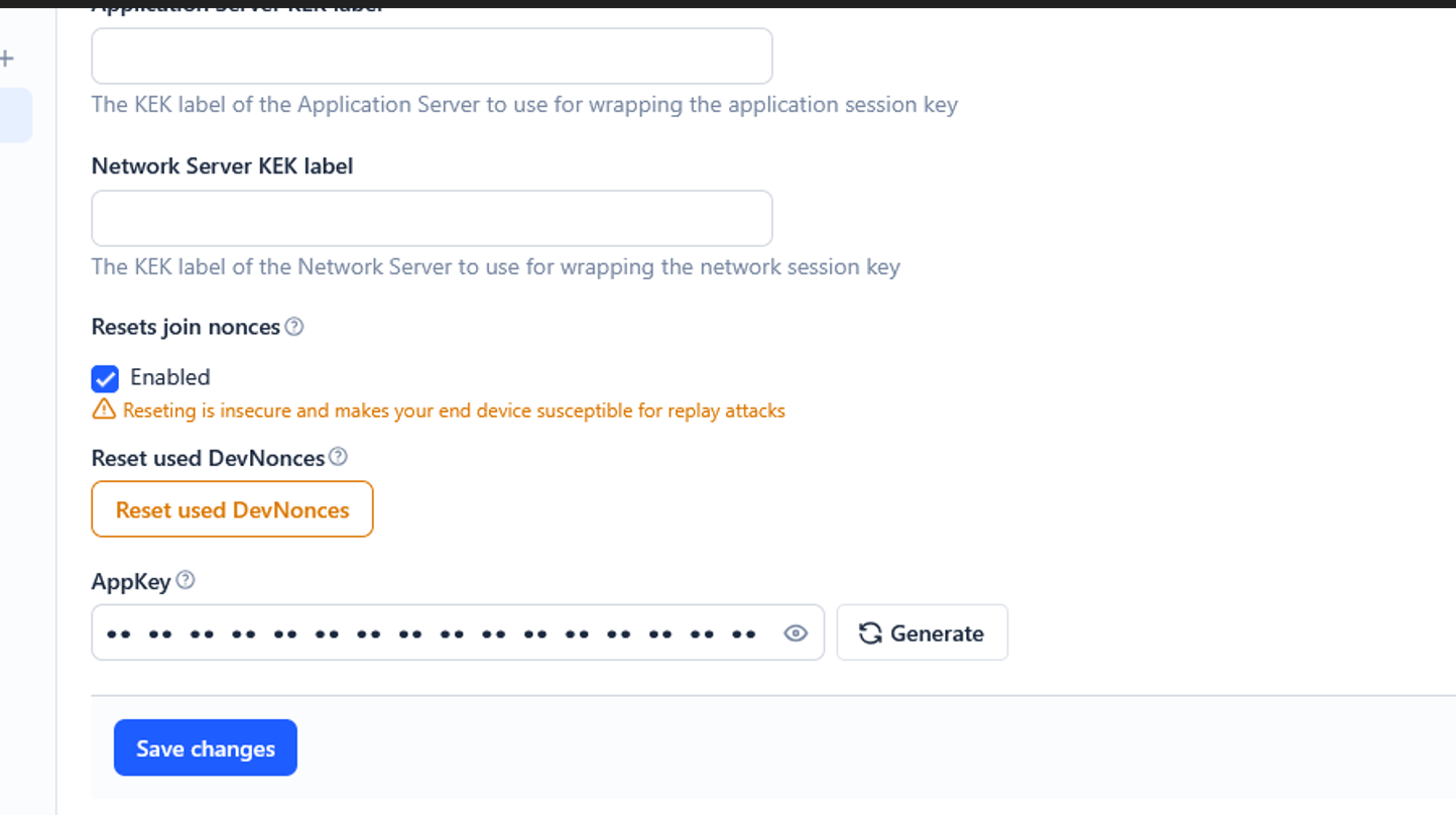

On TTN, with an application set as LoRaWAN Specification 1.0.2, end device as options
Resets join nonces:Enabled
Reset used DevNonces
but it seems that for Spec 1.0.2 this is irrelant, but it is for 1.0.4/1.1.0.

Questions:
- It is not needed to use a non-volatile memory on End Device when application is set as
LoRaWAN Specification 1.0.2, correct ? - Set End device ‘Resets join nonces:Enabled’ or ‘use Reset used DevNonces’ is not necessary when application is set as LoRaWAN Specification 1.0.2, correct ?
- Set End device ‘Resets join nonces:Enabled’ or ‘use Reset used DevNonces’ has no
effect when application is set as LoRaWAN Specification 1.0.2, correct ?
