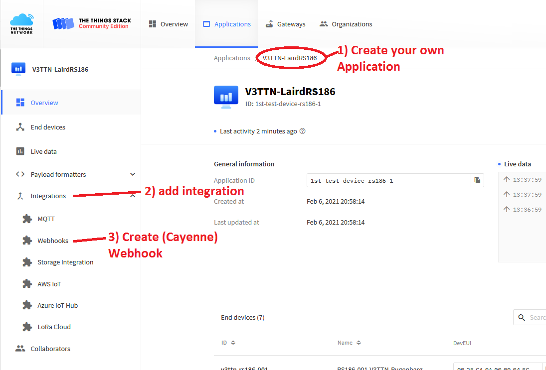

You now need to enable sending of the data to Cayenne to see it presented there…that is where the ‘Integration’ comes in - see left hand side menu of your TTN Application page on console…
Follow:…
i got the technical note about webhook settings of cayenne , i did the integration now , it is fine great thanks for the info about webhook setup , all data available in cayenne now
Thank you very much for your support
Ah see you have it now - ignore my graphic update! :slight_smile: :+1:
