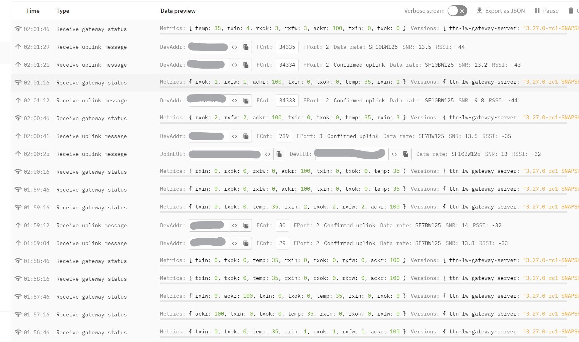

umm⦠well they were sitting right next to each other. now the sensor is about 20 ft away. below is what my gateway view looks like:
RSSI way to high for reliable device debug - as before Forum Search for seperation guidance (actually, its about RSSI management) - you dont want to be debugging RF issues and strange behaviours at same time as trying to debug set up/config issues - look for the goldilocks range - close is fine - if you have absorbers in between to reduce RSSI to manageable rangeā¦
P.S. no point redacting details - as you can see they show in GW console and hence in public domain - any GW hearing your node will show same details! - Only the Key is best kept secret - and Dev Addr is in a limited bounded range and hence many devices may have same value - its when used in combination with the other details/credentials that the LNS is able to route traffic correctly ![]()
Actually @808geek just noticed you are using Confirmed Uplinks - Please Dont! - Turn this off before we get into detailed assistance⦠(Again forum search will reveal a lot of discussion/guidance (direction!) on this - also ties into TTN FUPā¦)
