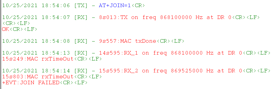

I get the following error on my serial COM port of end node:
10/25/2021 18:54:06 [TX] - AT+JOIN=1<CR>
10/25/2021 18:54:07 [RX] - 8s013:TX on freq 868100000 Hz at DR 0<CR><LF>
<CR><LF>
OK<CR><LF>
10/25/2021 18:54:08 [RX] - 9s557:MAC txDone<CR><LF>
10/25/2021 18:54:13 [RX] - 14s595:RX_1 on freq 868100000 Hz at DR 0<CR><LF>
15s249:MAC rxTimeOut<CR><LF>
10/25/2021 18:54:14 [RX] - 15s595:RX_2 on freq 869525000 Hz at DR 0<CR><LF>
15s803:MAC rxTimeOut<CR><LF>
+EVT:JOIN FAILED<CR><LF>

image.
