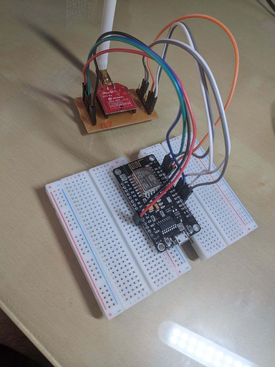

Hi everyone, I’m a newbie with arduino and LORA and I’m having some trouble with my first project.
I’m trying to connect a Dragino LoraBee (SX1276) with a ESP8266MOD to TheThingsNetwork, I have downloaded MCCI LoraWAN LMIC library and I have edited the file “lmic_project_config” to the europe region.
I have generated my ABP keys in the web and changed them in the ABP example file and I have defined the pinout.
The problem comes when I run the code, monitor serie gives me this output:

Pd: Sorry for posting simple doubts on the forum, but I couldn’t find any solution after trying different proposed solutions on the internet
What does the code on this line say?
PS, please format code & logs using the </> tool on the toolbar
This is oslmic.c from line 50 to 54, the error is produced on line 53 which is the one that have “ASSERT(0);
void os_init() {
    if (os_init_ex((const void *)&lmic_pins))
        return;
    ASSERT(0);
Yeah, I already knew that, I was wondering if you’d checked it and looked for any clues as to why it had thrown and assert?
