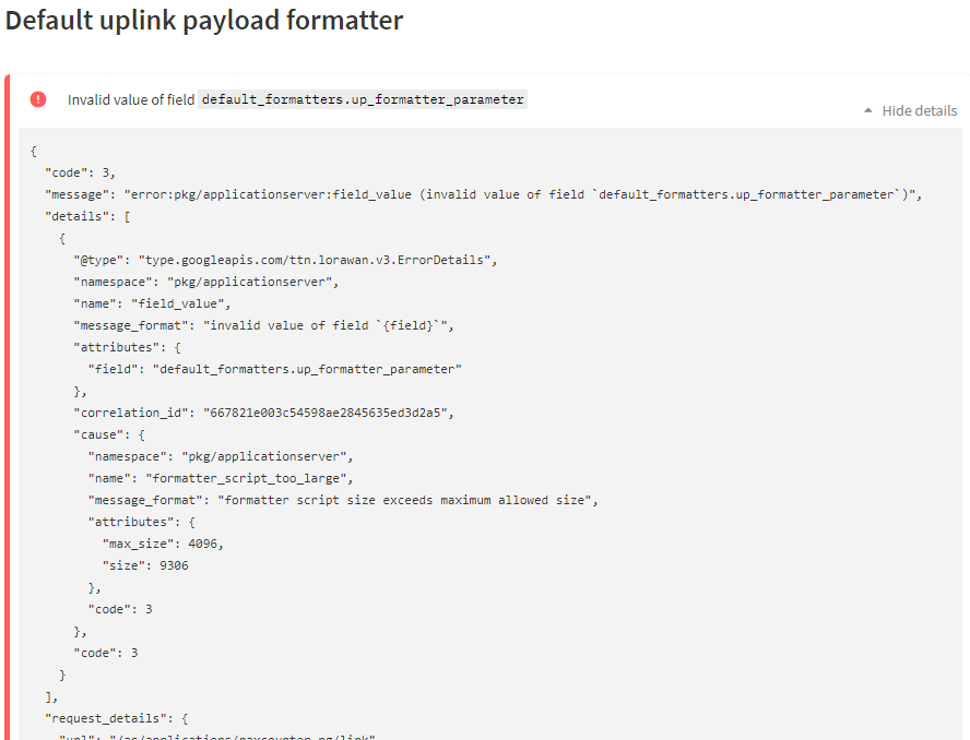

I want to upgrade my PaxCounter project to V3
But unfortunately the payload formater script is too long and cannot be saved on v3
Payload FormaterScript
screenshot of the error message:
There’s a lot of cruft and comments in there so you could minify it - plenty of utilities on the web to do that.
Or wait until it’s been made a bit bigger again, timescale unknown.
