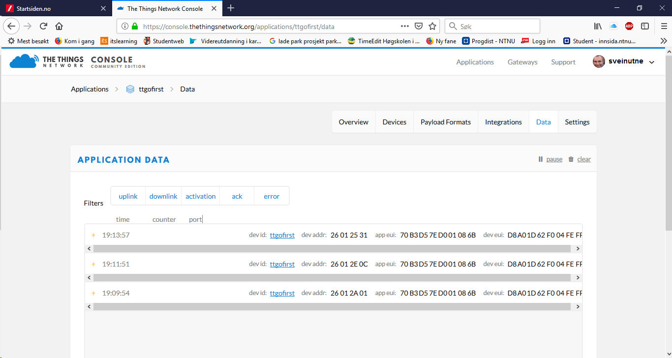

I pland to have esp32 with several sensors in my sailboat, and send the data by Lora to TTN and Cayenne. To get better reach I was planing to have the sensors and the esp32 in the bottom of the boat, and a second esp32 with Lora in the mast. The two esp32 connect with ESPNOW. I got three programs that is working. The first is reading the sensors, the second is sending and receiving data between two esp32, and the tird is talking to TTN with Lora. When I tried to murge the three programs into two, I got the sensor and ESPNOW to work, but the one with Lora and ESPNOW is not working right. I put in a lot of debugging lines, but it will not connect to TTN. I will uploade the code, and hope some experts can find the bug.
[details]
