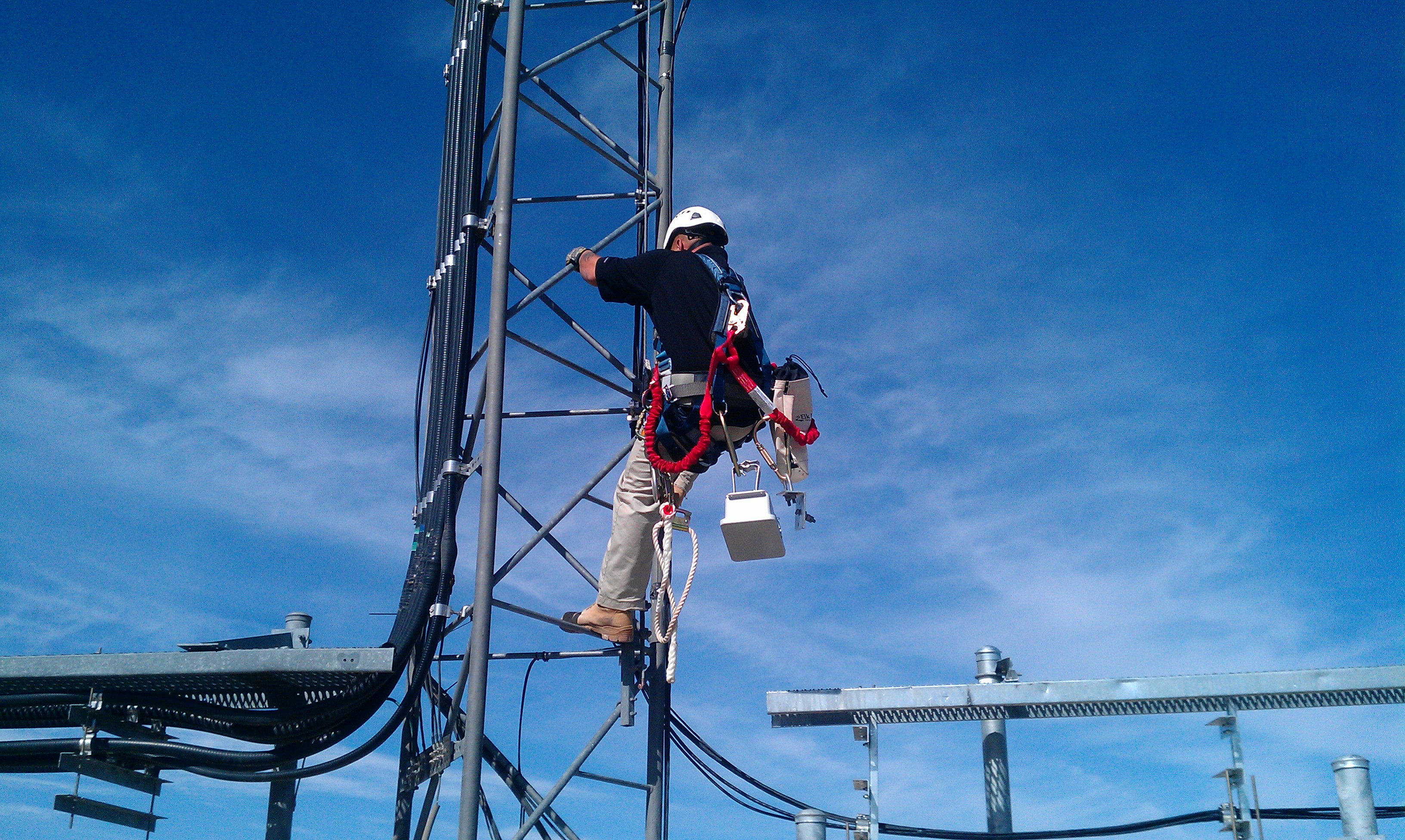

Good tower riggers know how to do all this but some are real butchers and will cost you money for repair climbs.

Very lastly, I’ve sent a lot of people up towers and I have the utmost respect for them. It’s not something that I could ever do!
Tower-01

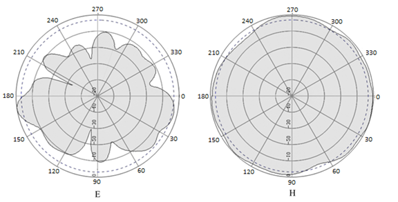

Have a look at the new 6dBi antenna from RAK. It has about 10 degrees of downtilt at 920MHz, may provide better outcome than an antenna that’s providing 6dBi in the horizontal.

(Tim Everitt) #6
Hi @everhamme, I should have added that it’s best to have everything ready at the base of the tower first, then send the climber up, then do a first commissioning check while the climber is still up the tower. Only get the climber down once you are happy that the install appears to be ok.
Also, get the climber to take detailed photos of the install at the top of the tower.
(Tony Smith) #7
Yes, that’s the one. Compare its polar diagrams with other antennas to select the best antenna for your site.
