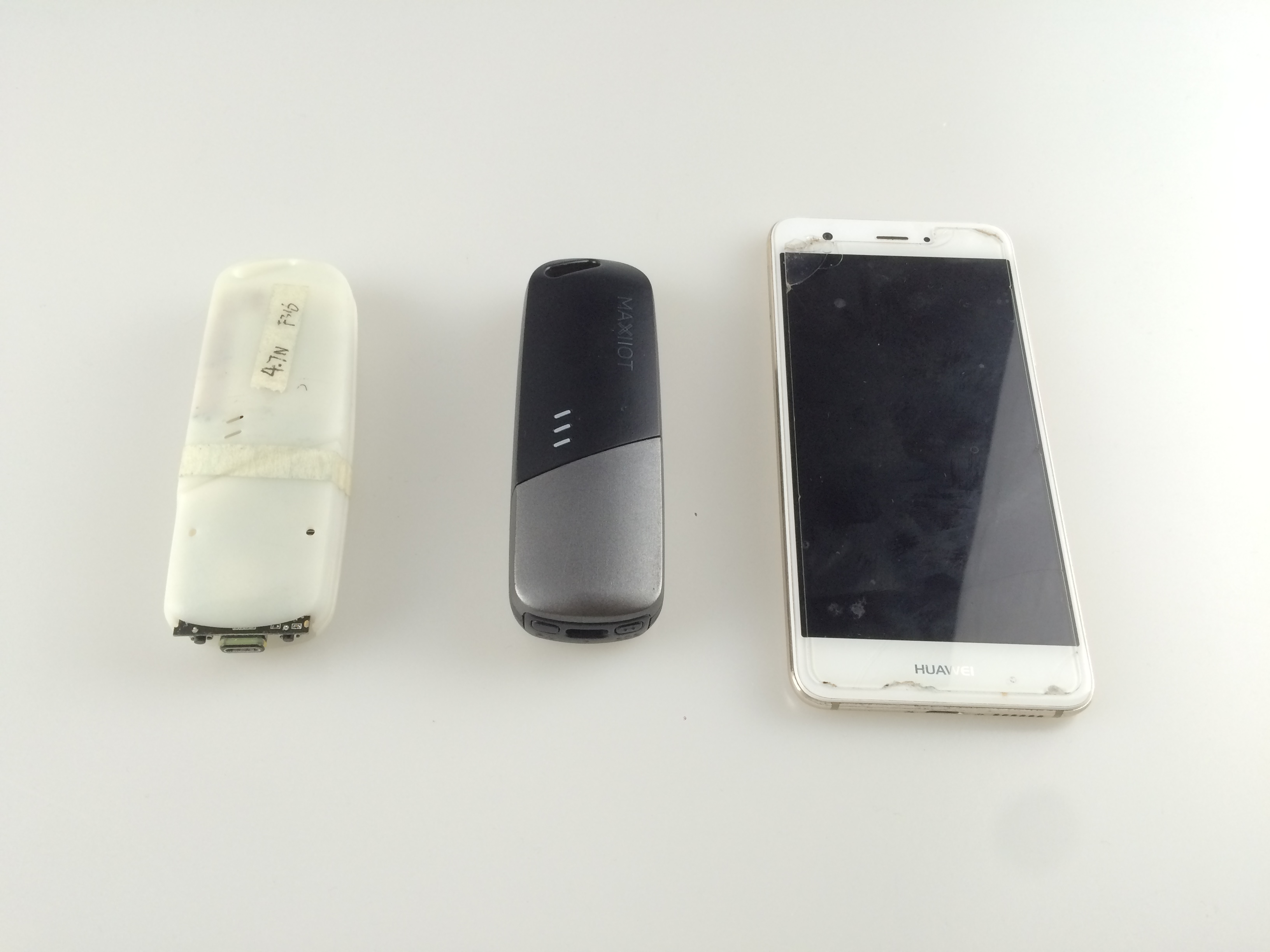

Required devices: 2LoRa GPS Tracker+1 mobile phone.

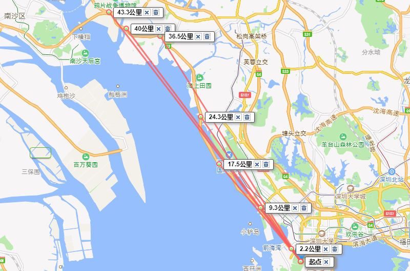

The following are some representative data:
  1. Starting Point( where node1 is ) : Observation deck of Nanshan. about 275 meters above sea level.
  2. Near Qianhai branch of ABC : node2 is 2.2KM away from node1, few buildings around, high receive sensitivity , no packet loss.
  3. Close to Bihai fortis city iii:node2 is 9.3KM away from node1, no building around, high receive sensitivity , signal stable, no packet loss.
  4. Near Bao’an International Airport:node2 is 17.5KM away from node1,Packet loss rate increasing sharply due to the impact of airport signal shielding ,when left airport area , signal recover , no packet loss .
  5. Fuyong toll station:node2 is 24.3KM away from node1, no building around, high receive sensitivity , signal stable, no packet loss.
  6. Near Xin’an East Road,Dongguan:node2 is 36.5KM away from node1, no building around, high receive sensitivity , signal stable, no packet loss.
  7. NiutauShan Tunnel:node2 is 40.0KM away from node1, packet loss rate increase due to the impact of mountains .
  8. Near Dongguan University of Technology :node2 is 43.3KM away from node1, a lot buildings around, packet loss rate increase to 100% due to urban environment , test ended .
