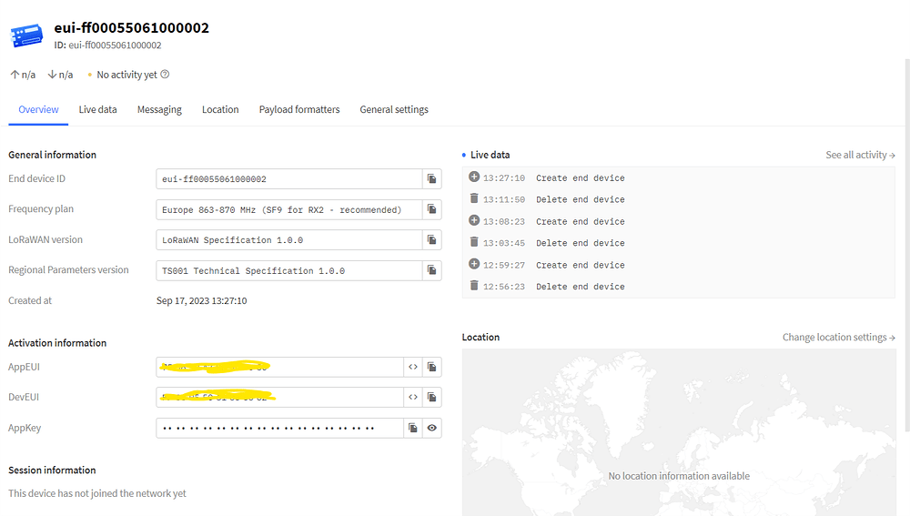

and for the not joining part i send a screen shot for more details.
in the session information part, it says this device has not joined the network yet.
Do you have a gateway?
no. it seems like that this terminal would find a near lorawan gateway and send the data itself, so there is no need to register a new gateway in the things stack. all i do was register the device itself.
It won’t find anything - if there is a TTN community gateway that hears it, you are in luck, if not, you need to get your own gateway. Most developers have a gateway for debugging.

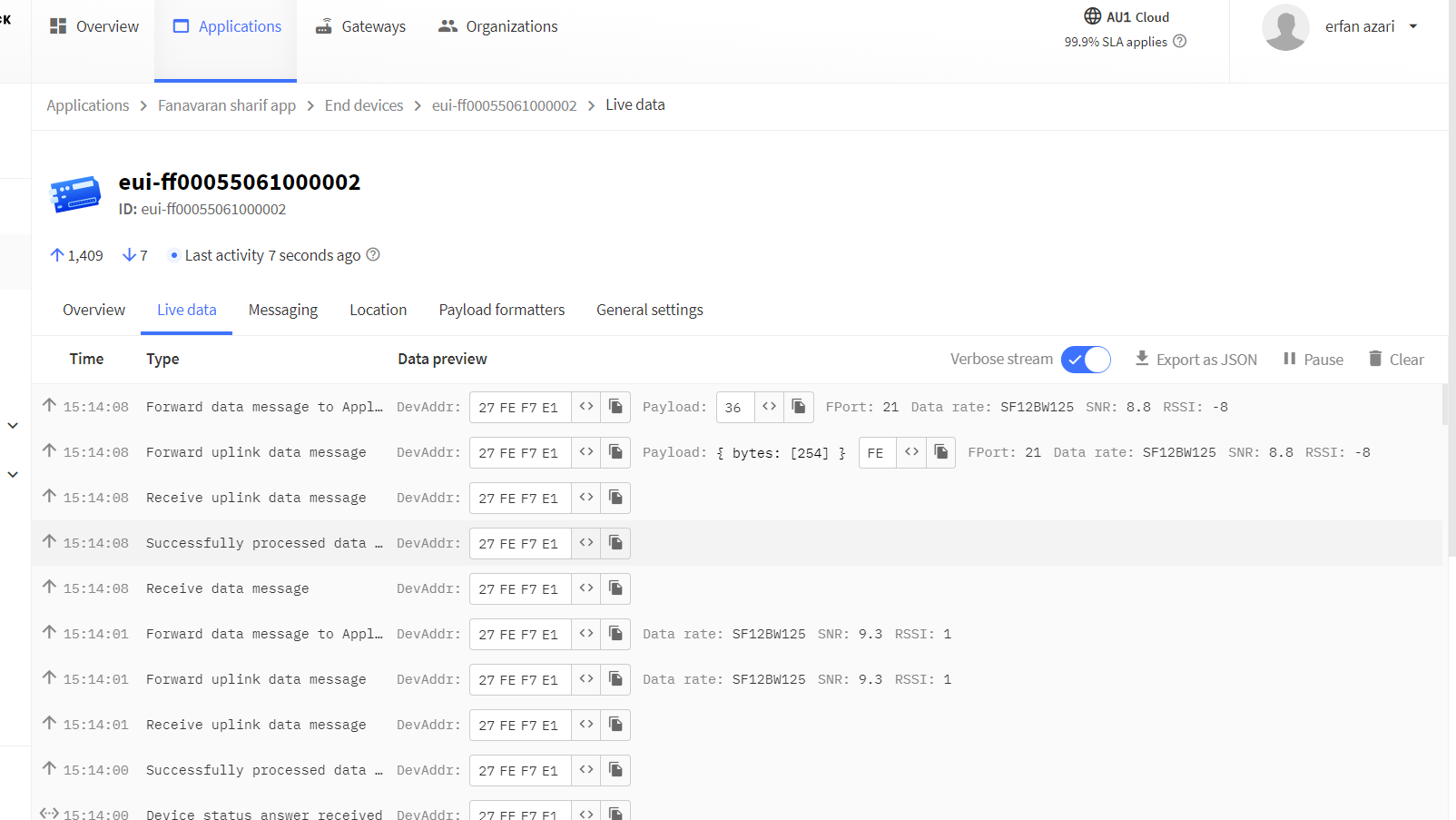

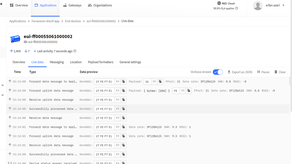

dear sir, finally i managed to set up my own gateway. im using F8926-GW. my gateway is connected and the F8L10T terminal is connected too in the end devices and has a session.

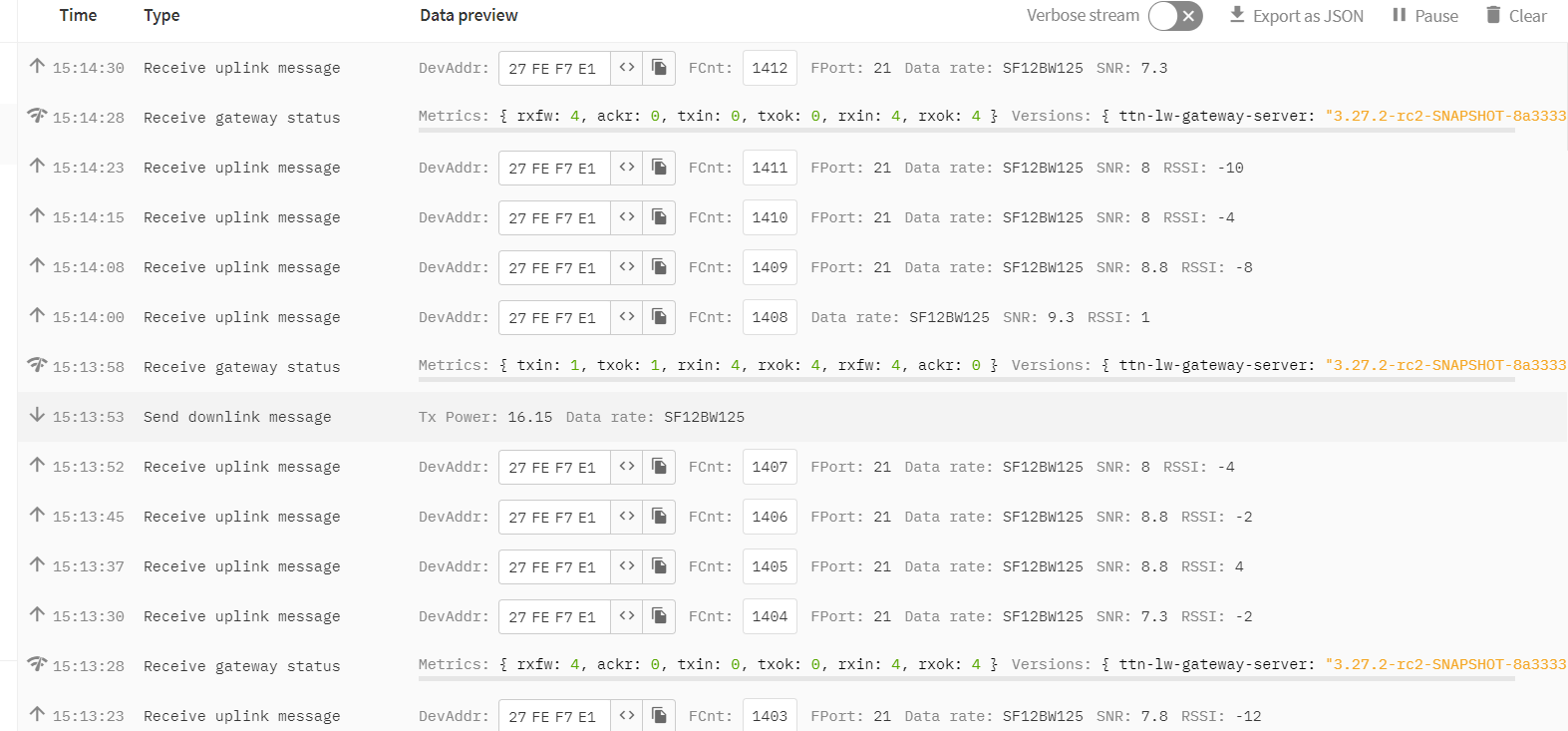

my new problem is that i dont recieve the data from the sensors which are connected to the F8L10T terminal. all i recieve is FE as payload. i attach some screen shots to give you more information.

You are massively breaching the TTN community Fair Use Policy.
Have you read the manuals or downloaded the configuration software?
Suspending thread until you have confirmed you are complying with the FUP, that’s if TTI support don’t suspend your account first.
Please change the uplink interval immediately to comply with TTN fair use policy and legal requirements. You are sending far too often.
Your node is using SF12 which takes seconds to send a minimal amount of information and the RSSI and SNR allow for better settings, probably SF7 where it takes 1/32th of the time to send the same amount of data.
