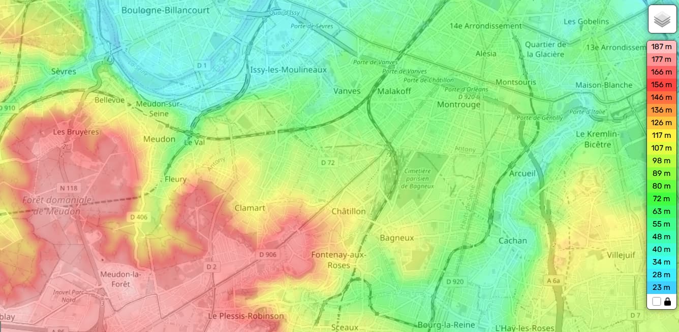

The ‘idealised’ maps and potential coverage is often discussed on the forum (search top right) and often leads to confusion and high expectations. Everything is dependent on locations (yours and the gw’s and the intervening built environment and topology. How close are you to the target GW’s? What is between you (do you have clean LOS)? What is respective elevation. A crude look suggests 3 or 4 potential GW’s N/NE of where you might be at around 1-5km distance, however can see e.g. Montparnasse/Brest Rail line between which if on an embankment vs a deep cut and if GW’s and device at low position wrt local ground may mean there is RF shadowing. You need to be specific and look at how topology may impact. These pic may help you get to grips:

Local Topology:

There appears to be an indoor GW close by (a TTIG) but that doesn’t look to have been online for a while now (shown Red) and such GW’s often have limited longer range coverage as distant RF signals have to penetrate into the host building to reach the GW. The coverage circles are very much ‘idealised’ as you can be <500m from one and not get a signal but may find you are >10km away and get hits fine.
Simples! Get you own! They are not expensive and if you deploy a gateway in your own location you help add to and build the Community coverage and help ‘gap fill’. We usually recommend that if you are looking to do you own development (devices, firmware, s/w, end applications etc.) then that is a must do to ensure you have reliable coverage.
Location of the device may be important if switch/power meter is close to ground level you may also see problems due to Freznel Zone issues (Forum Search and GIYF) so mount (atleast antenna) higher (typically >>1m)
