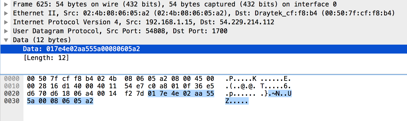

20:49:54.097783 IP (tos 0x0, ttl 64, id 19847, offset 0, flags [DF], proto UDP (17), length 40)
192.168.1.27.57860 > 54.229.214.112.1700: [udp sum ok] UDP, length 12
0x0000: 4500 0028 4d87 4000 4011 1e25 c0a8 011b Eā¦(M.@.@ā¦%ā¦
0x0010: 36e5 d670 e204 06a4 0014 35b2 0151 ff02 6ā¦pā¦5ā¦Qā¦
0x0020: aa55 5a00 0806 05a2 .UZā¦
20:49:54.125439 IP (tos 0x0, ttl 51, id 36451, offset 0, flags [DF], proto UDP (17), length 32)
54.229.214.112.1700 > 192.168.1.27.57860: [udp sum ok] UDP, length 4
0x0000: 4500 0020 8e63 4000 3311 ea50 36e5 d670 Eā¦c@.3ā¦P6ā¦p
0x0010: c0a8 011b 06a4 e204 000c 47c1 0151 ff01 ā¦Gā¦Qā¦
0x0020: 0000 0000 0000 0000 0000 0000 0000 3db7 ā¦=.
0x0030: 685d h]
I might be wrong here but it seems the TTN server is responding wrong to my PULL_DATA message:
According to the Semtech documentation Iām sending protocol 0x01, token 0x7e 0x4e and PULL_DATA identifier 0x02, plus the EUI of my gateway in the remaining 8 octets. Next I receive a response from the TTN server:
Again protocol 0x01, token 0x7e 0x4e, but this time the next octet is 0x01, this is a PUSH_Ack and not a PULL_Ack. This seems why the Kerlink is barfing over this: it is expecting a 0x04.

Adding this in your local_conf.json will āfixā it:
āautoquit_thresholdā: 0,
I suspect there is an issue in the TTN gateway, itās not responding correctly to PULL_ACK requests, I reported it to @johan and he labeled the issue as ābugā ā¦
