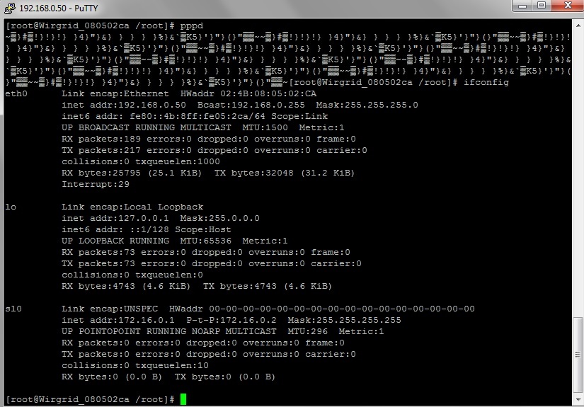

No, there is no ppp0 interface when I check with ifconfig. Does this mean my APN settings are incorrect? Or is there something else complicating the issue?
Launch pppd by just typing it in the command line, then look again.
Still nothing, running pppd brings up a bunch of indiscernible nonsense, and ifconfig is identical.
See attached screenshot

There is no SIM code enabled, I double checked using a home network 3G modem.
Checking the log files, I see this when running pppd:
daemon.notice pppd[1417]: pppd 2.4.5 started by root, uid 0
daemon.info pppd[1417]: Using interface ppp0
daemon.notice pppd[1417]: Connect: ppp0 <–> /dev/pts/1
daemon.warn pppd[1417]: LCP: timeout sending Config-Requests
daemon.notice pppd[1417]: Connection terminated.
daemon.notice pppd[1417]: Modem hangup
daemon.info pppd[1417]: Exit.
What operator are you using? What APN did you set?
Please paste relevant parts of /etc/sysconfig/network
