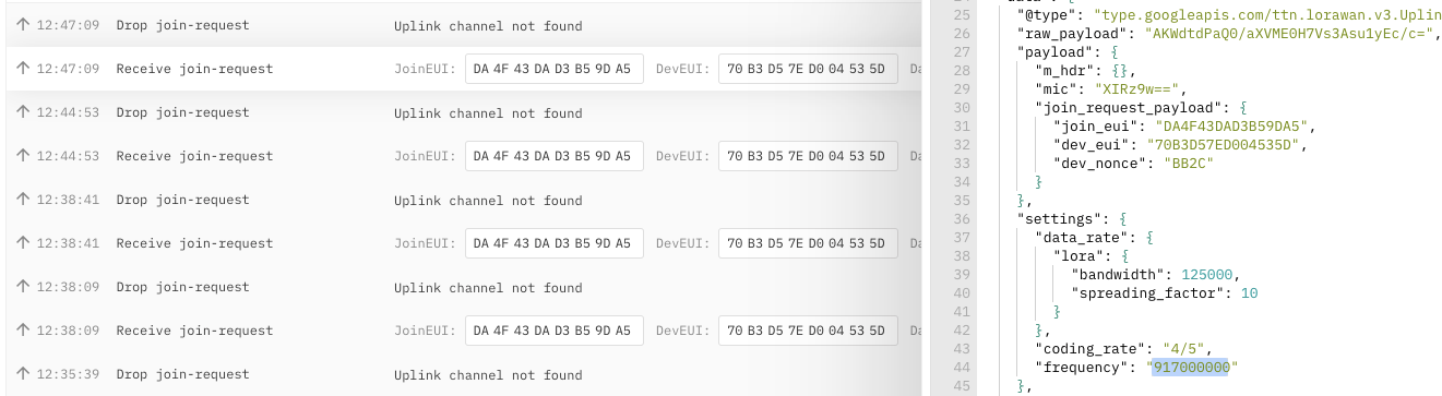

@cslorabox I’m using now the verbose option, and I see an “Uplink channel not found”. Maybe it is a Gateway problem?

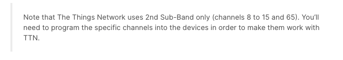

@cslorabox, I was reading here:
https://www.thethingsnetwork.org/docs/lorawan/frequency-plans/#au915-928

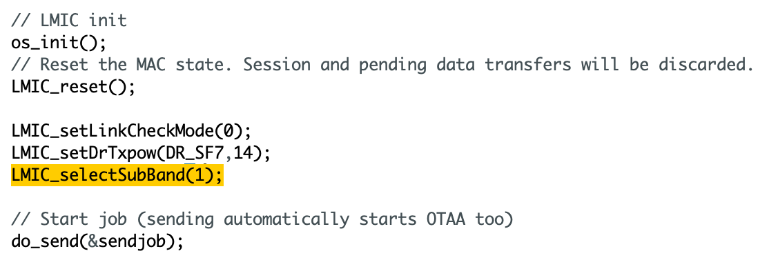

And maybe I have to select subBand 2 in this part of my code?
Very sorry to have made you guys waste your time. It appears that it is a frequency config problem.
