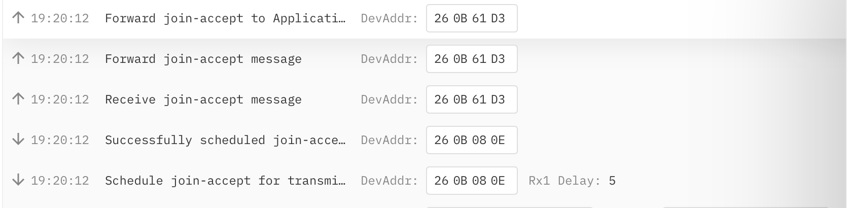

The join procedure is now working 100% of the time, as the live data pane in the console suggests!!
Screenshot 2021-05-19 at 19.23.59
HOWEVER, the python script ends up giving me a join failed, even though the join accept message is sent.
Does this mean that the node does not receive the join accept message? Anyone else who have come across this problem?
