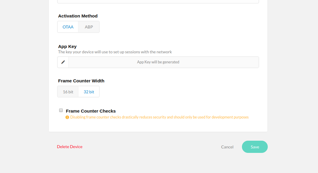

Even though the frame counter checks are unchecked the ttn still counts them and send them to the device.
Can I stop that?

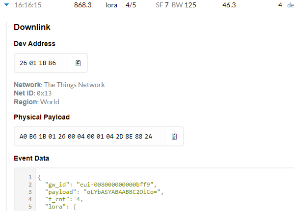

No you can not. The LoRaWAN specification states transmitted frames should use incrementing frame counters. TTN allows ignoring the counter when receiving data to help users developing and testing ABP nodes however the back-end needs to increase the counter on transmission otherwise nodes might ignore the (potentially duplicate) packets on reception.
Thank you but if I reset the frame counter from ttn console the next time it sends a zero value this means that the ttn is generating that number and it sending it to my device (with the downlink) where probably the device it self is doing some checks. I wanted to know if there is any way to automatically reset the back-end count…
