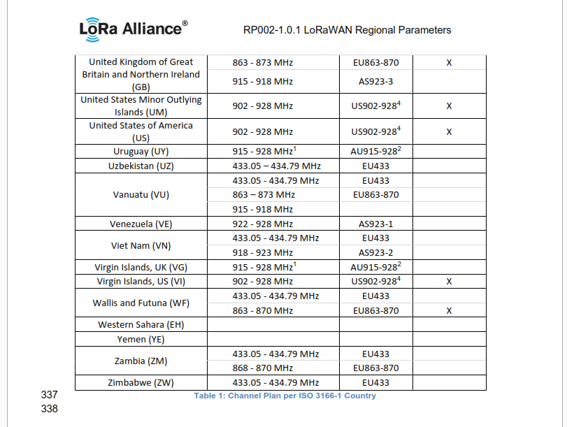

Recommendation is start with the LoRa-Alliance latest RP’s. version RP002-1.0.1 from early 2020 calls out the EU433 band as option, havent looked to see if anything changed or added since. As stated always double check local regs, though L-A wont list until they a local agreement the authorties - the TTN documentation dating back to old V2 version used this (L-A RP) as its reference, but hasnt been updated to reflect the 2020 update for RP2 and still shows Uzbekistan as a blank field.
