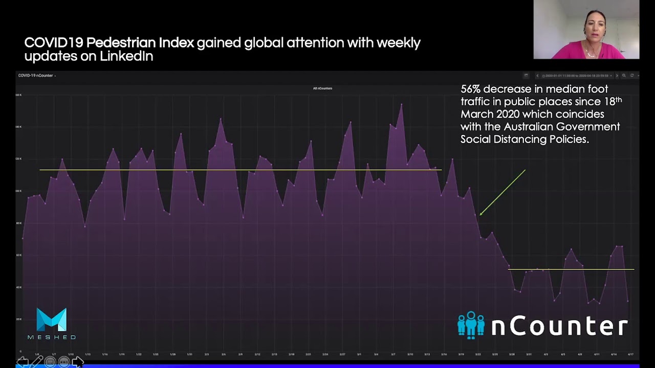

BTW anyone reading this who missed Catherine’s presentation to the recent TTConf virtual sessions may want to catch up with this video ![]()

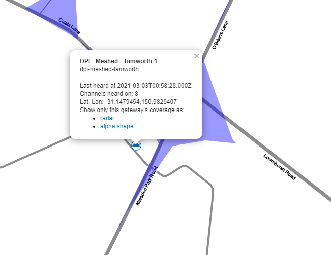

Hi Maj.
Please don’t get aggressive with your language. Meshed does run the gateway i referred to at Loomberah. when Meshed is advertised on all these gateways, am I to assume it is some sort of other Meshed? or it is owned by someone else like the DPI. it does not say DPI Tamworth.
the gateway is located over near Loomberah, which is near Tamworth.
We only know that gateway as “Tamworth” (as defined by our customer). I haven’t heard of Loomberah before and they have never referred to it as that. My response would have been different if you’d referred to it by name.
As far as I’m aware it is fully operational and has been since it was installed. If you have reason to believe otherwise, please let me know why.
The party that is entitled to make that assertion disagrees with your point of view.

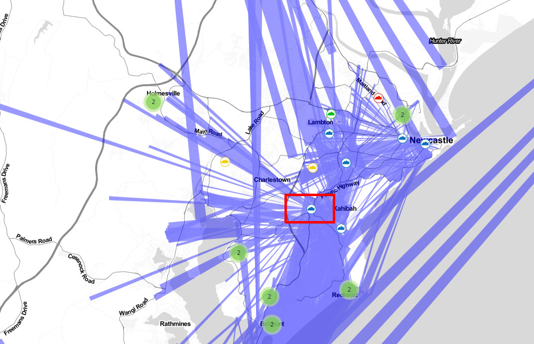

Looks like you are facing similar challenges to us, @Scobber. Newcastle/Lake Mac had at one stage AU915, AS923-AS1, AS923-AS2 all operating in the same region. While we’ve been able to settle with AS923 in this region, as you can see in this thread, some of the most prime located Meshed gateways around town remain as AS923-only.
In Tamworth, the Meshed gateway appears to have the second-best altitude of the five located (4 belong to others). Sadly, the Meshed gateway appears to be AS923-only. The knock-on effect is going to be disgruntled end-users such as yourself who are left wondering why it doesn’t work as prescribed. Makers, engineers, educators and students will find that projects work on one side of town but not the other. If it’s anything like it was for us + Meshed, the only way forward is for the whole Tamworth TTN community to unify with a non-compliant LoRaWAN region configuration.
The other 4 Tamworth community gateways are operating on AU915 (which should be working fine if you are following Australian region LoRaWAN specificaion):
Though given the outcome of recent decisions:
Once V3 is in motion, if the Meshed gateway is still AS923-only then it might be worth getting in touch with the local council (assuming they are the owners) to have the gateway removed from the TTN map (citing this conversation and the Australian TTN Page which capture the community consensus that AS923-only gateways are actively discouraged)
