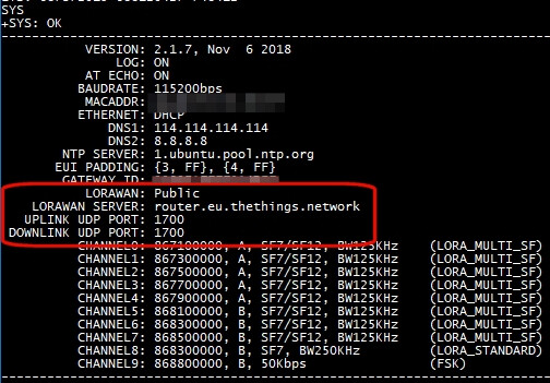

and, after that, will it essentially become “free” and unattached?
Indeed.
There is no new firmware available; I think it’s just a matter of changing the “lorawan server” address from ‘router.eu.thethings.network’ to ‘eu1.cloud.thethings.network’ ?
