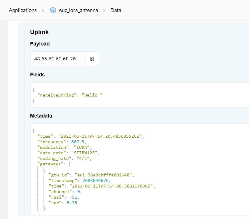

Hello just a quick answer what are the units of the RSSI and SNR that the code is measured?
Unit is usually -dbm, ie ref to 1mW (0dbm). So if a node tx’s @ +14dbm and rssi indicated -80dbm, you have a link budget of 94db :slight_smile:
metrisis lora i need those two units
Which code? Code dependent…all I’m telling you is the convention ( and remember we are effectively dealing in ratio’s)… not clear what you are looking at or how implemented… but that would be a logical conclusion/assumption if implemented correctly :wink:
Edit: ah posts crossed… see additional info now… yes that would be the reported level (referenced to 0dbm). If you search the forum you will also find lots of historic discussions about how nodes and GW’s might be calculating and reporting the values and how they and underlying algorithms used as part of the Semtech device calculations have developed and evolved (Refer to Semtech device specifications & application notes - GIYF!)
Rssi is ref 0dm, snr is a ratio (so just a dB), as above. LoRa can work with signals below the noise floor vs legacy modulation schemes such as fsk where you need a signal a decent amount above the noise floor, so it’s poss to see snr as either a +ve or -ve value depending on local rf environment…
