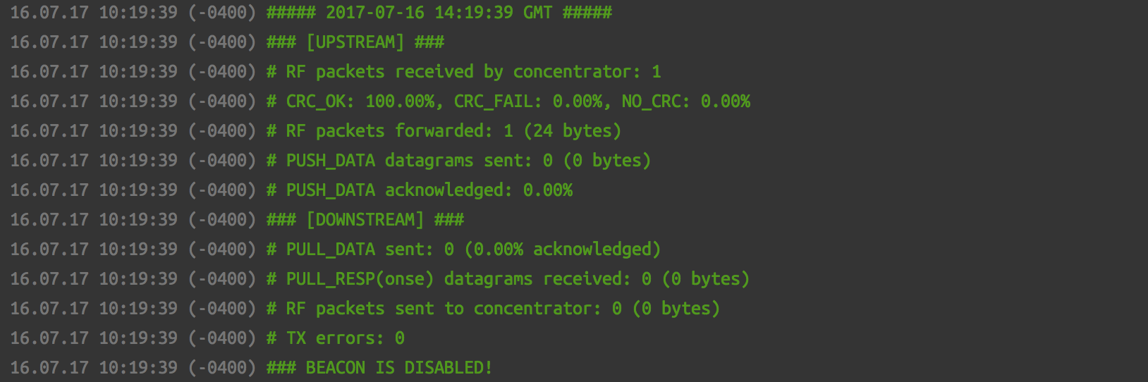

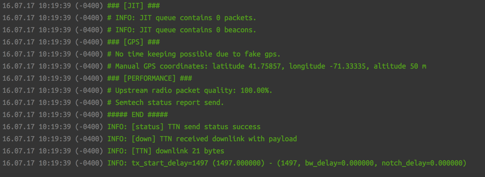

Ok I have an update…I do receive the 21 byte test packet on the my risingHF gateway so I am happy it works.The confirmation is in the INFO comments at 10:19:39. Why are the PULL_DATA messages showing no transmission or are they meant for something else?
See the (old) protocol specifications; downlinks are not direct responses to PULL_DATA:
5.2.3 PULL_DATA message
The PULL_DATA messages are periodically transmitted to the LoRa network server in order to inform the server of the UDP port number to which the network server should send any PULL_RESP message.
Also, the logging is totally up to your gateway implementation; to reliably see all traffic between your gateway and TTN, you’d need to sniff it.
PULL DATA is for the Semtech protocol. You are connecting to TTN using the TTN protocol. The last 3 lines indicate you are receiving downlink data which is scheduled for transmission.
Ah, indeed the logs say PULL_DATA sent: 0. I didn’t notice that.
