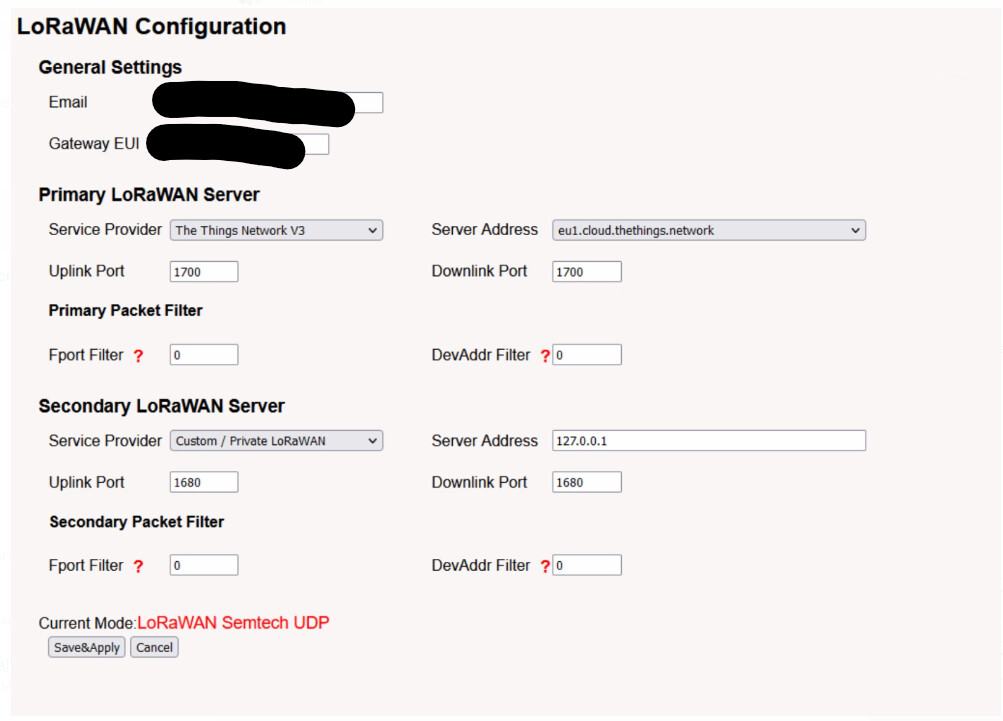

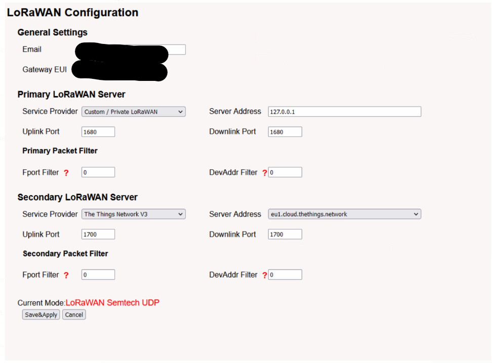

I think I already have the solution, I had HELIUM as the first network and TTN as the second network:
Now I have turned them around and it seems to work, I will do more tests but it seems that it works well:
