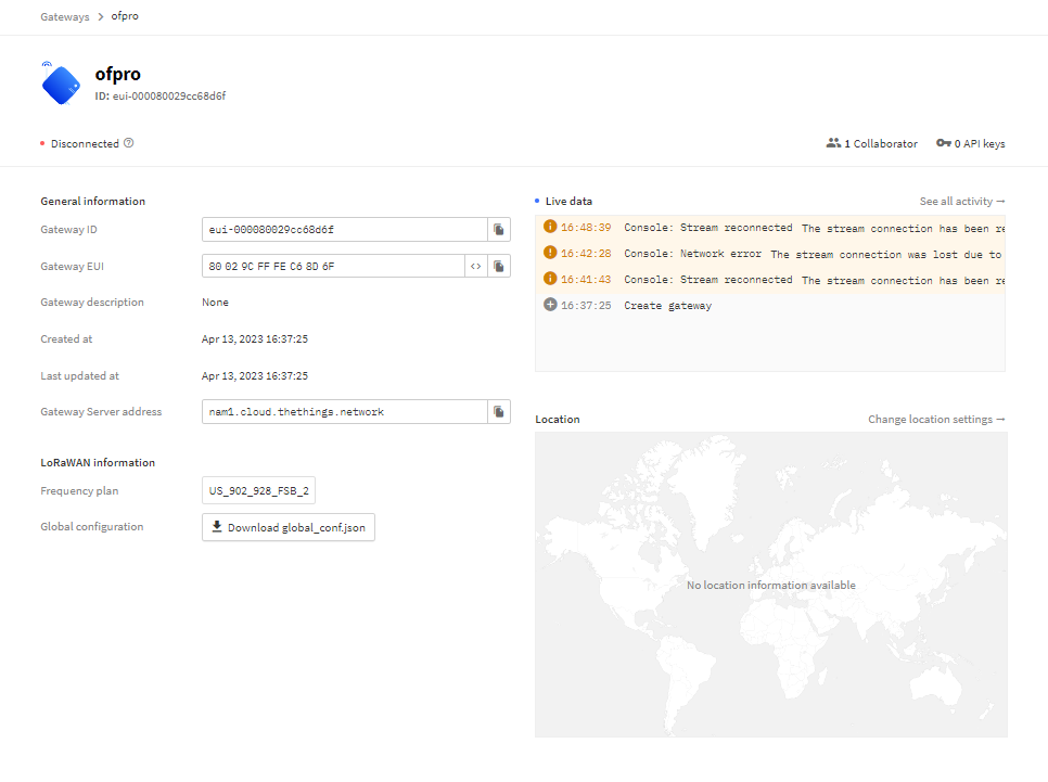

Regardless of all the channel plan options, if the EUI / Id is set and the network isn’t blocking the connection to the servers, you should see a “heart-beat” in the activity section.

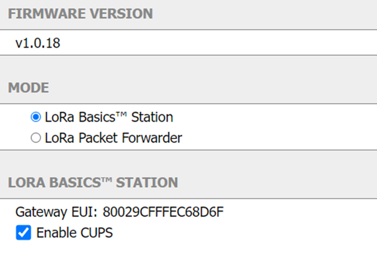

Where did you get the EUI from? Why does the screen shot show a Gateway ID that is different? How many posts on this forum explain that the words vendors use do not always match the right words?

This is where i got the EUI, once i enter AP mode on the gateway…

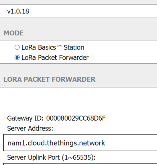

And this is where i got the gateway ID
Now the ID shown matches the id i got from the AP mode
The gateway is ON with the LED steady green but no changes on the console
This - for PF mode it is typical that the EUI is called ID.
You are currently using the BS EUI with the PF setup.
Yes! That seemed to be the problem, it is working now, I just registered my gateway using the ID shown in the AP mode as PF, just set that on the EUI part on The things Network and it gave me signals of connection.
