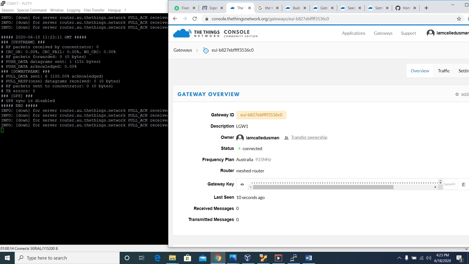

Hi All
Thanks for the help , today i reinstalledconnected the OS and all the packages again .Now successfully connected . I have attached the image .
BR
Usman
