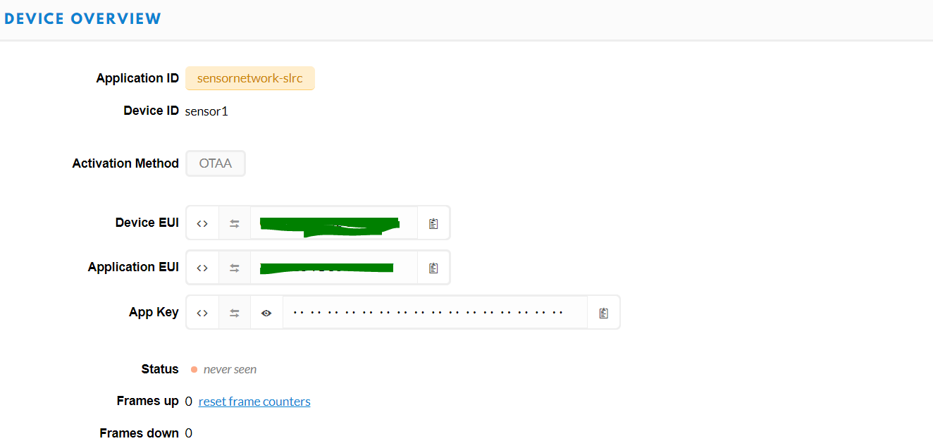

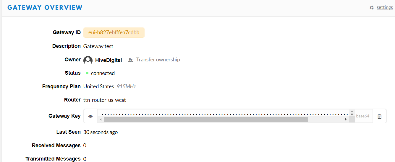

The gateway I use is a RPI 3 with a Pi Supply HAT where I am receiving the packets from my sensor node. The gateway connects to the TTN server but I get no data traffic or packets. Hence the Application in the Console shows that the device has not been seen.

What I’ve tried so far:
  • Starting a new application on TTN’s console.
  • Updating the App EUI and App Key.
  • Resetting the Arduino board.
  • No wiring and/or hardware issues.
Any ideas??
Very important! I am on the US-west server, so I know that it has been fully re-deployed just yesterday so it may come still with some maintenance left to do. So if there is someone from the US-west who can reply if their gateway-sensor node system is up and running that would be helpful.
